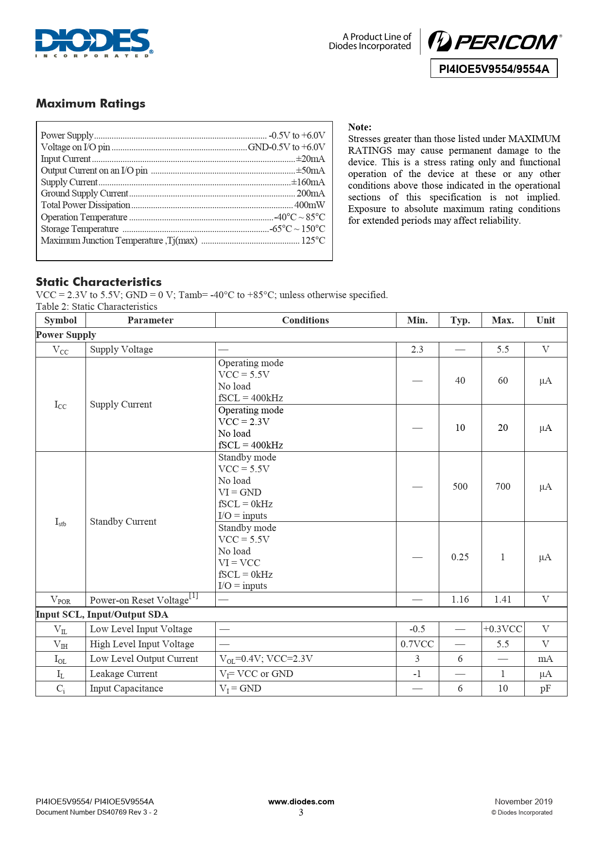

PI4IOE5V9554/9554A Maximum Ratings Note:
Power Supply ... -0.5V to +6.0V Stresses greater than those listed under MAXIMUM Voltage on I/O pin .. GND-0.5V to +6.0V RATINGS may cause permanent damage to the Input Current ... ±20mA device. This is a stress rating only and functional Output Current on an I/O pin .. ±50mA operation of the device at these or any other Supply Current .. ±160mA conditions above those indicated in the operational Ground Supply Current .. 200mA sections of this specification is not implied. Total Power Dissipation .. 400mW Exposure to absolute maximum rating conditions Operation Temperature .. -40°C ~ 85°C for extended periods may affect reliability. Storage Temperature ... -65°C ~ 150°C Maximum Junction Temperature ,Tj(max) ... 125°C
Static Characteristics
VCC = 2.3V to 5.5V; GND = 0 V; Tamb= -40°C to +85°C; unless otherwise specified. Table 2: Static Characteristics
Symbol Parameter Conditions Min. Typ. Max. Unit Power Supply
VCC Supply Voltage — 2.3 — 5.5 V Operating mode VCC = 5.5V No load — 40 60 μA I fSCL = 400kHz CC Supply Current Operating mode VCC = 2.3V No load — 10 20 μA fSCL = 400kHz Standby mode VCC = 5.5V No load VI = GND — 500 700 μA fSCL = 0kHz I I/O = inputs stb Standby Current Standby mode VCC = 5.5V No load VI = VCC — 0.25 1 μA fSCL = 0kHz I/O = inputs VPOR Power-on Reset Voltage[1] — — 1.16 1.41 V
Input SCL, Input/Output SDA
VIL Low Level Input Voltage — -0.5 — +0.3VCC V VIH High Level Input Voltage — 0.7VCC — 5.5 V IOL Low Level Output Current VOL=0.4V; VCC=2.3V 3 6 — mA IL Leakage Current VI= VCC or GND -1 — 1 μA Ci Input Capacitance VI = GND — 6 10 pF PI4IOE5V9554/ PI4IOE5V9554A
