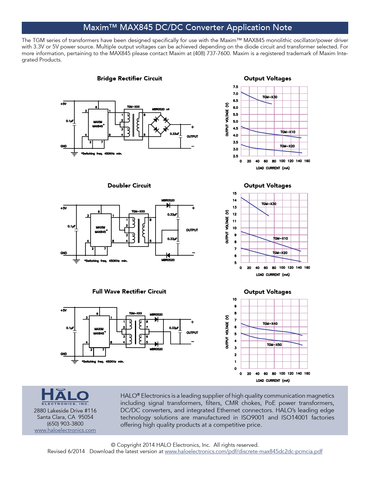

Bridge Rectifier Circuit. Output Voltages. Doubler Circuit. Full Wave Rectifier Circuit
Bridge Rectifier Circuit Output Voltages Doubler Circuit Full Wave Rectifier Circuit
Maxim™ MAX845 DC/DC Converter Application Note The TGM series of transformers have been designed specifically for use with the Maxim™ MAX845 monolithic oscillator/power driver with 3.3V or 5V power source. Multiple output voltages can be achieved depending on the diode circuit and transformer selected. For more information, pertaining to the MAX845 please contact Maxim at (408) 737-7600. Maxim is a registered trademark of Maxim Inte- grated Products.
Bridge Rectifier Circuit Output Voltages Doubler Circuit Output Voltages Full Wave Rectifier Circuit Output Voltages
