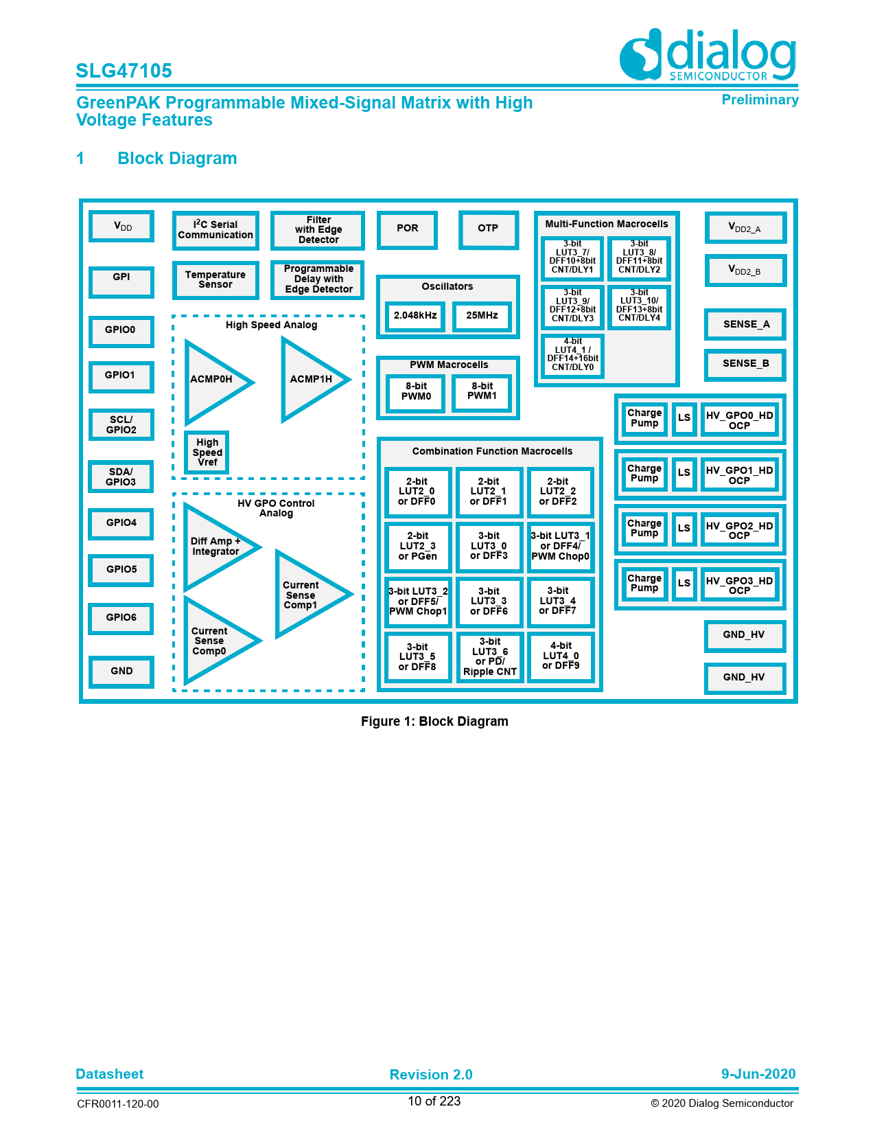

SLG47105. GreenPAK Programmable Mixed-Signal Matrix with High. Preliminary. Voltage Features. Block Diagram. Filter. I2C Serial
SLG47105 GreenPAK Programmable Mixed-Signal Matrix with High Preliminary Voltage Features Block Diagram Filter I2C Serial
SLG47105 GreenPAK Programmable Mixed-Signal Matrix with High Preliminary Voltage Features 1 Block Diagram Filter V I2C Serial Multi-Function Macrocells
DD
with Edge POR OTP V
DD2_A
Communication Detector 3-bit 3-bit LUT3_7/ LUT3_8/ DFF10+8bit DFF11+8bit Programmable CNT/DLY1 CNT/DLY2 V Temperature
DD2_B
GPI Delay with Sensor Edge Detector Oscillators 3-bit 3-bit LUT3_9/ LUT3_10/ DFF12+8bit DFF13+8bit 2.048kHz 25MHz CNT/DLY3 CNT/DLY4 High Speed Analog SENSE_A GPIO0 4-bit LUT4_1 / DFF14+16bit PWM Macrocells CNT/DLY0 SENSE_B GPIO1 ACMP0H ACMP1H 8-bit 8-bit PWM0 PWM1 Charge SCL/ LS HV_GPO0_HD Pump GPIO2 OCP High Speed Combination Function Macrocells Vref SDA/ Charge LS HV_GPO1_HD GPIO3 2-bit 2-bit 2-bit Pump OCP LUT2_0 LUT2_1 LUT2_2 HV GPO Control or DFF0 or DFF1 or DFF2 Analog GPIO4 Charge LS HV_GPO2_HD 2-bit 3-bit 3-bit LUT3_1 Pump OCP Diff Amp + LUT2_3 LUT3_0 or DFF4/ Integrator or PGen or DFF3 PWM Chop0 GPIO5 Charge Current LS HV_GPO3_HD Pump Sense 3-bit LUT3_2 3-bit 3-bit OCP Comp1 or DFF5/ LUT3_3 LUT3_4 PWM Chop1 or DFF6 or DFF7 GPIO6 Current GND_HV Sense 3-bit 4-bit Comp0 3-bit LUT3_6 LUT3_5 LUT4_0 or PD/ or DFF9 GND or DFF8 Ripple CNT GND_HV Figure 1: Block Diagram Datasheet Revision 2.0 9-Jun-2020
