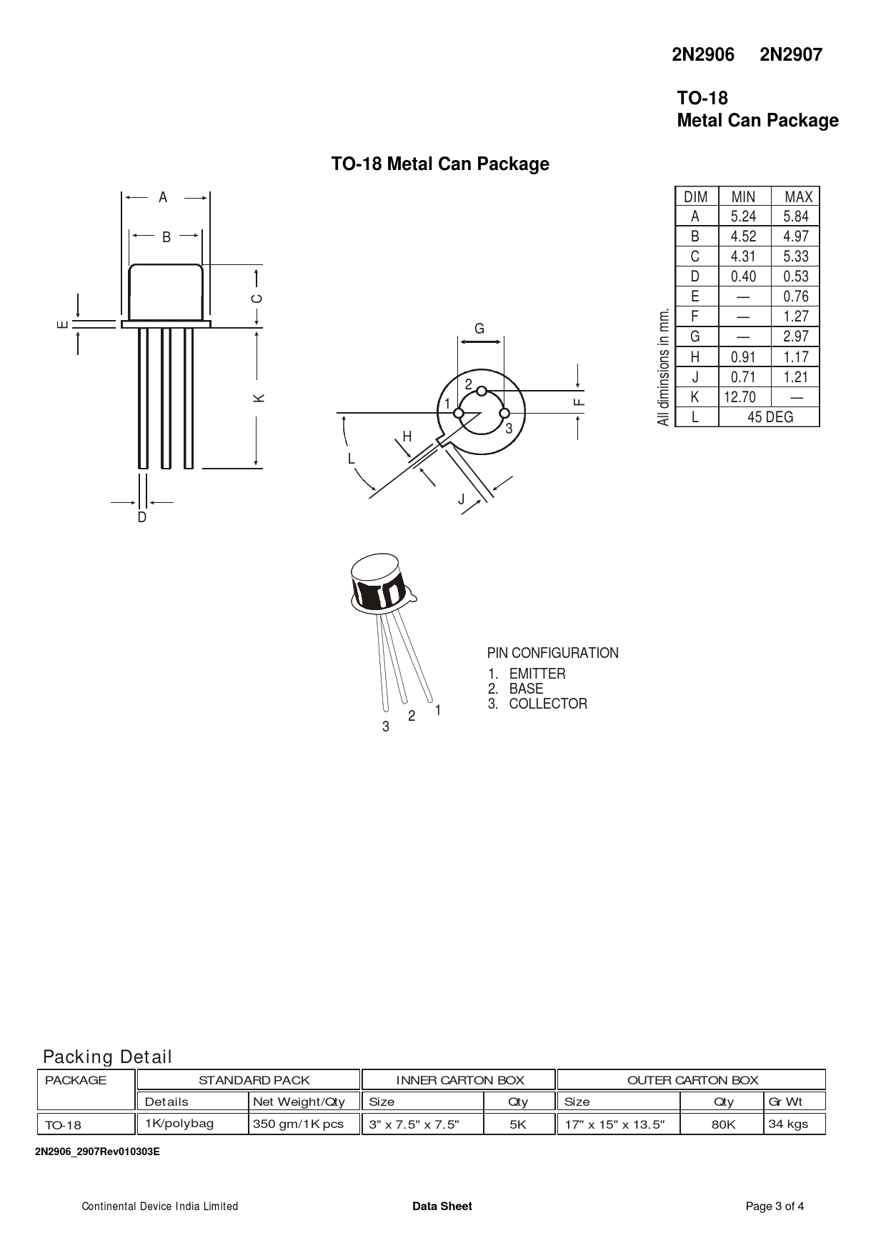

DescriptionPNP Silicon Planar Switching Transistor
Pages / Page4 / 3 — 2N2906 2N2907. TO-18 Metal Can Package. Packing Detail. Details. Net …
File Format / SizePDF / 145 Kb
2N2906 2N2907. TO-18 Metal Can Package. Packing Detail. Details. Net Weight/Qty. Size. Qty. Gr Wt. TO-18. 1K/polybag. 350 gm/1K pcs
2N2906 2N2907 TO-18 Metal Can Package Packing Detail Details Net Weight/Qty Size Qty Gr Wt TO-18 1K/polybag 350 gm/1K pcs
2N2906 2N2907 TO-18 Metal Can Package TO-18 Metal Can Package
A DIM MIN MAX A 5.24 5.84 B B 4.52 4.97 C 4.31 5.33 D 0.40 0.53 C E — 0.76 . E m F — 1.27 G G — 2.97 H 0.91 1.17 2 insions in m J 0.71 1.21 K 1 F K 12.70 — L 45 DEG 3 Al dim H L J D PIN CONFIGURATION 1. EMITTER 2. BASE 3. COLLECTOR 1 2 3
Packing Detail
PACKAGE STANDARD PACK INNER CARTON BOX OUTER CARTON BOX
Details Net Weight/Qty Size Qty Size Qty Gr Wt TO-18 1K/polybag 350 gm/1K pcs 3" x 7.5" x 7.5" 5K 17" x 15" x 13.5" 80K 34 kgs 2N2906_2907Rev010303E
