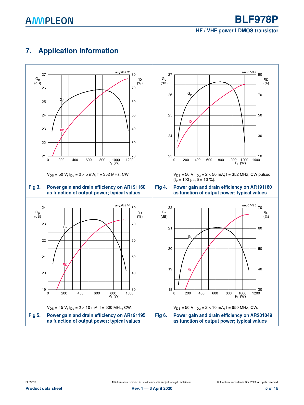

BLF978P. HF / VHF power LDMOS transistor. 7. Application. information. Fig 3. Power gain and drain efficiency on AR191160. Fig 4
BLF978P HF / VHF power LDMOS transistor 7 Application information Fig 3 Power gain and drain efficiency on AR191160 Fig 4
BLF978P HF / VHF power LDMOS transistor 7. Application information
amp01412 amp01413 27 80 27 90 Gp G ηD Gp G ηD (dB) (dB) (dB) (%) (%) (%) (dB) (dB) (dB) (%) (%) (%) 26 70 26 Gp G 70 G 25 p G 60 24 50 25 50 ηD 23 η 40 D 24 30 22 30 21 20 23 10 0 200 400 600 800 1000 1200 0 200 400 600 800 1000 1200 1400 PL (W) PL (W) VDS = 50 V; IDq = 2  5 mA; f = 352 MHz; CW. VDS = 50 V; IDq = 2  50 mA; f = 352 MHz; CW pulsed (tp = 100 s;  = 10 %).
Fig 3. Power gain and drain efficiency on AR191160 Fig 4. Power gain and drain efficiency on AR191160 as function of output power; typical values as function of output power; typical values
amp01414 amp01415 24 80 22 70 Gp G ηD Gp G ηD (dB) (dB) (dB) (%) (%) (%) (dB) (dB) (dB) (%) (%) (%) 23 70 Gp G 21 60 Gp G 22 60 20 50 21 50 ηD 19 η 40 D 20 40 19 30 18 30 0 200 400 600 800 1000 0 200 400 600 800 1000 1200 PL (W) PL (W) VDS = 45 V; IDq = 2  10 mA; f = 500 MHz; CW. VDS = 50 V; IDq = 2  10 mA; f = 650 MHz; CW.
Fig 5. Power gain and drain efficiency on AR191195 Fig 6. Power gain and drain efficiency on AR201049 as function of output power; typical values as function of output power; typical values
