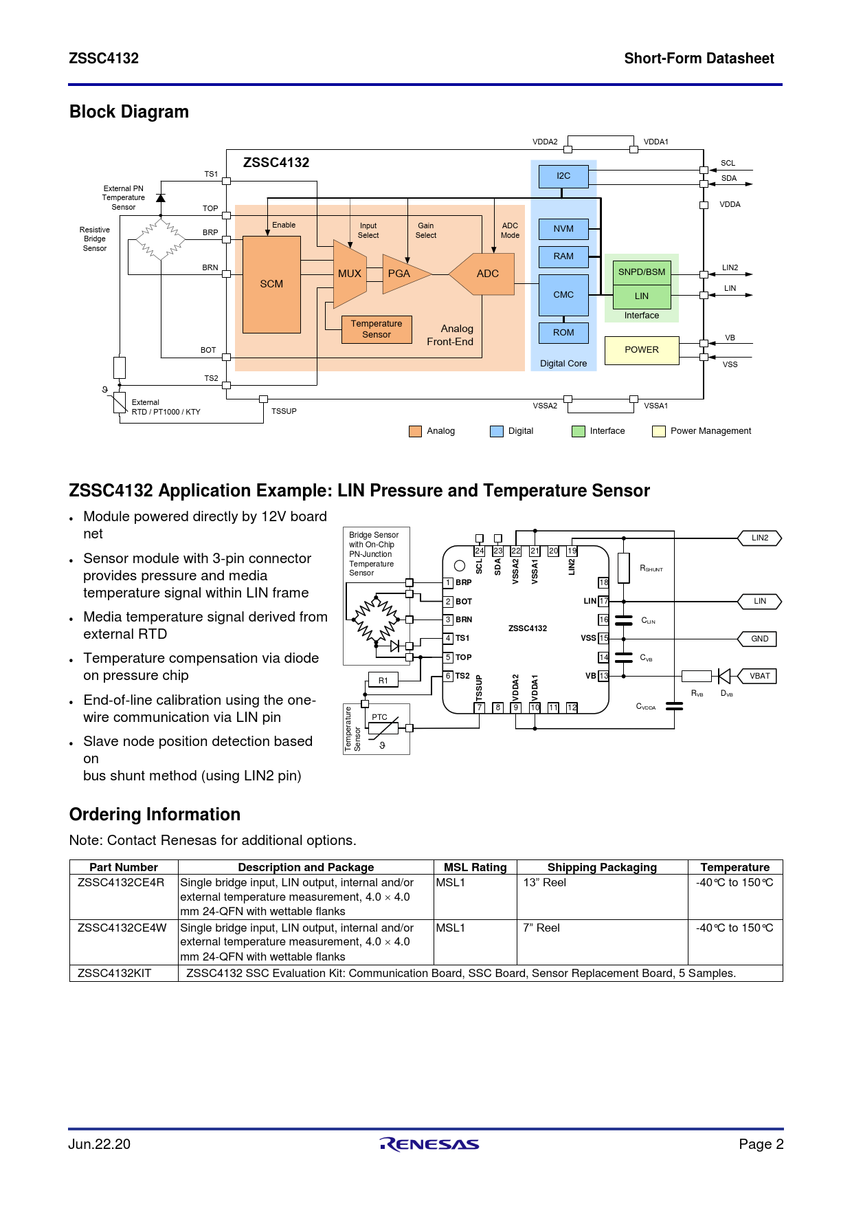

ZSSC4132. Short-Form Datasheet. Block Diagram. ZSSC4132 Application Example: LIN Pressure and Temperature Sensor. BRP. VSSA. BOT. LIN
ZSSC4132 Short-Form Datasheet Block Diagram ZSSC4132 Application Example: LIN Pressure and Temperature Sensor BRP VSSA BOT LIN
VDDA2 VDDA1
ZSSC4132
SCL TS1 I2C SDA External PN Temperature Sensor TOP VDDA Enable Input Gain ADC Resistive BRP NVM Select Select Mode Bridge Sensor RAM BRN MUX PGA ADC LIN2 SNPD/BSM SCM LIN CMC LIN Interface Temperature Analog Sensor ROM Front-End VB BOT POWER Digital Core VSS TS2  External VSSA2 VSSA1 RTD / PT1000 / KTY TSSUP Analog Digital Interface Power Management
Module powered directly by 12V board net Bridge Sensor LIN2 with On-Chip 24 23 22 21 20 19 PN-Junction Sensor module with 3-pin connector
L A 2 1 2
Temperature
NI
R provides pressure and media SHUNT
SC
Sensor
SD L
1
BRP VSSA VSSA
18 temperature signal within LIN frame 2
BOT LIN
17 LIN Media temperature signal derived from 3
BRN
16 CLIN external RTD
ZSSC4132
4
TS1 VSS
15 GND Temperature compensation via diode 5
TOP
14 CVB on pressure chip 6
TS2 P 2 1 VB
13 VBAT R1
A A D D SSU D D
RVB DVB End-of-line calibration using the one-
T V V
C 7 8 9 10 11 12 VDDA re wire communication via LIN pin ut PTC ra e r so n Slave node position detection based mp e e  T S on bus shunt method (using LIN2 pin)
Ordering Information
Note: Contact Renesas for additional options.
Part Number Description and Package MSL Rating Shipping Packaging Temperature
ZSSC4132CE4R Single bridge input, LIN output, internal and/or MSL1 13” Reel -40°C to 150°C external temperature measurement, 4.0  4.0 mm 24-QFN with wettable flanks ZSSC4132CE4W Single bridge input, LIN output, internal and/or MSL1 7” Reel -40°C to 150°C external temperature measurement, 4.0  4.0 mm 24-QFN with wettable flanks ZSSC4132KIT ZSSC4132 SSC Evaluation Kit: Communication Board, SSC Board, Sensor Replacement Board, 5 Samples. Jun.22.20 Page 2
