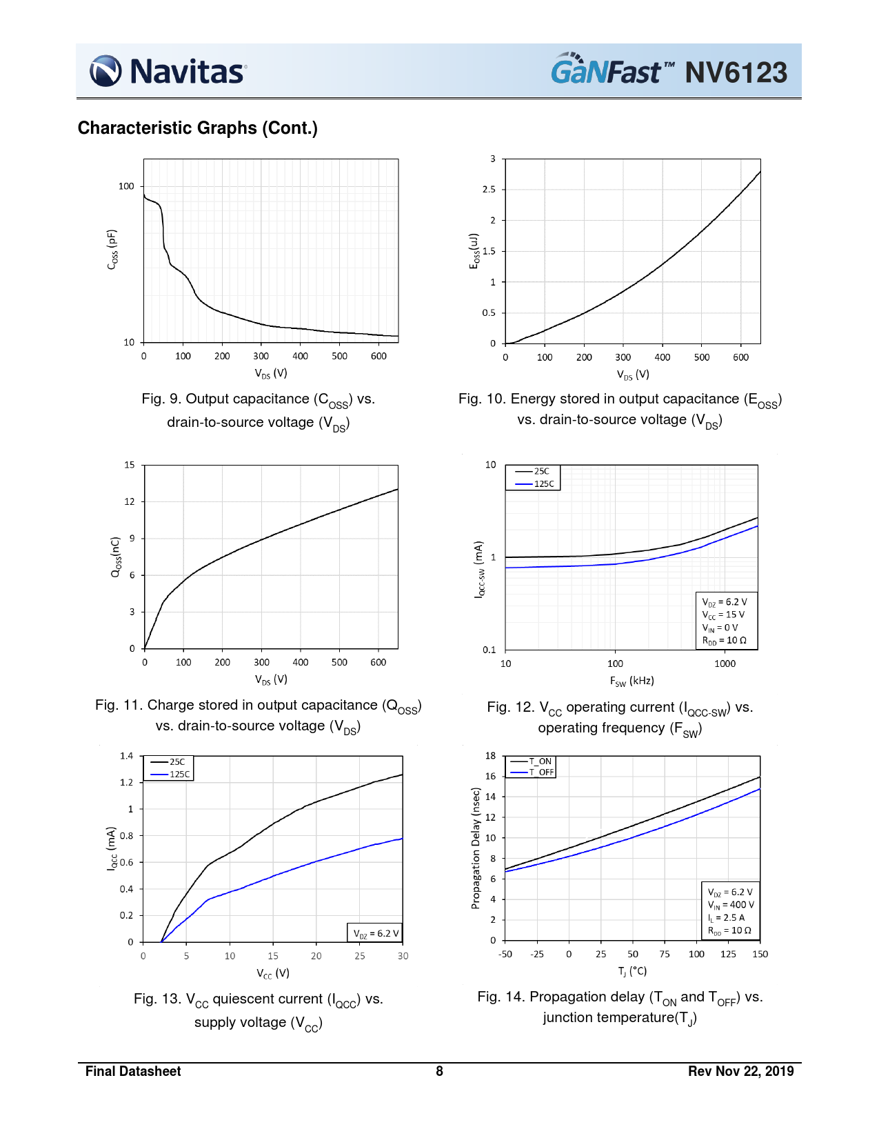

NV6123 Characteristic Graphs (Cont.)
Fig. 9. Output capacitance (C ) vs. Fig. 10. Energy stored in output capacitance (E ) OSS OSS drain-to-source voltage (V ) vs. drain-to-source voltage (V ) DS DS Fig. 11. Charge stored in output capacitance (Q ) Fig. 12. V operating current (I ) vs. OSS CC QCC-SW vs. drain-to-source voltage (V ) DS operating frequency (F ) SW Fig. 13. V quiescent current (I ) vs. Fig. 14. Propagation delay (T and T ) vs. CC QCC ON OFF supply voltage (V ) junction temperature(T ) J CC
