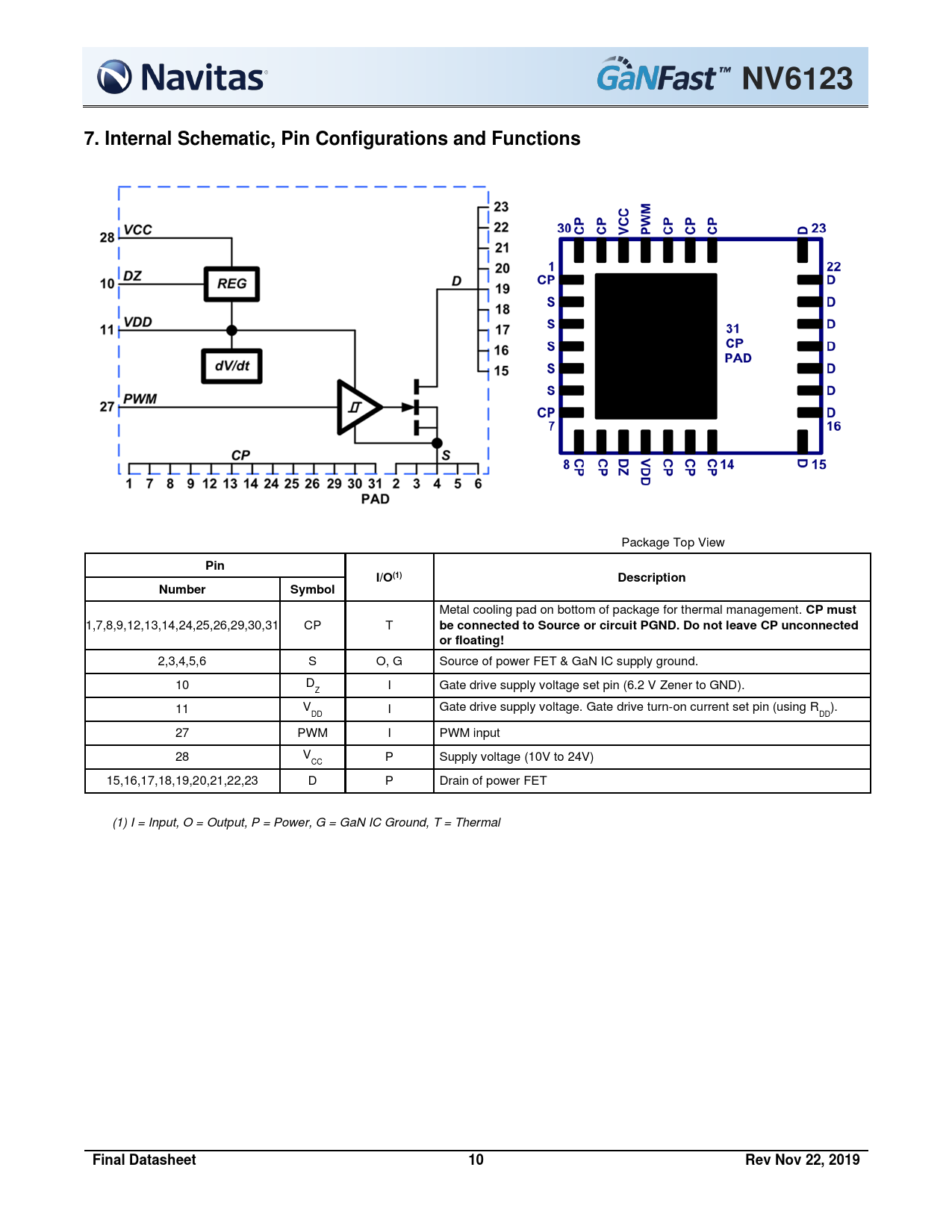

NV6123. 7. Internal Schematic, Pin Configurations and Functions. Pin. I/O(1). Description. Number. Symbol. CP must
NV6123 7 Internal Schematic, Pin Configurations and Functions Pin I/O(1) Description Number Symbol CP must
NV6123 7. Internal Schematic, Pin Configurations and Functions
Package Top View
Metal cooling pad on bottom of package for thermal management.
CP must
1,7,8,9,12,13,14,24,25,26,29,30,31 CP T
be connected to Source or circuit PGND. Do not leave CP unconnected or floating!
2,3,4,5,6 S O, G Source of power FET & GaN IC supply ground. 10 D I Gate drive supply voltage set pin (6.2 V Zener to GND). Z 11 V I Gate drive supply voltage. Gate drive turn-on current set pin (using R ). DD DD 27 PWM I PWM input 28 V P Supply voltage (10V to 24V) CC 15,16,17,18,19,20,21,22,23 D P Drain of power FET (1) I = Input, O = Output, P = Power, G = GaN IC Ground, T = Thermal
