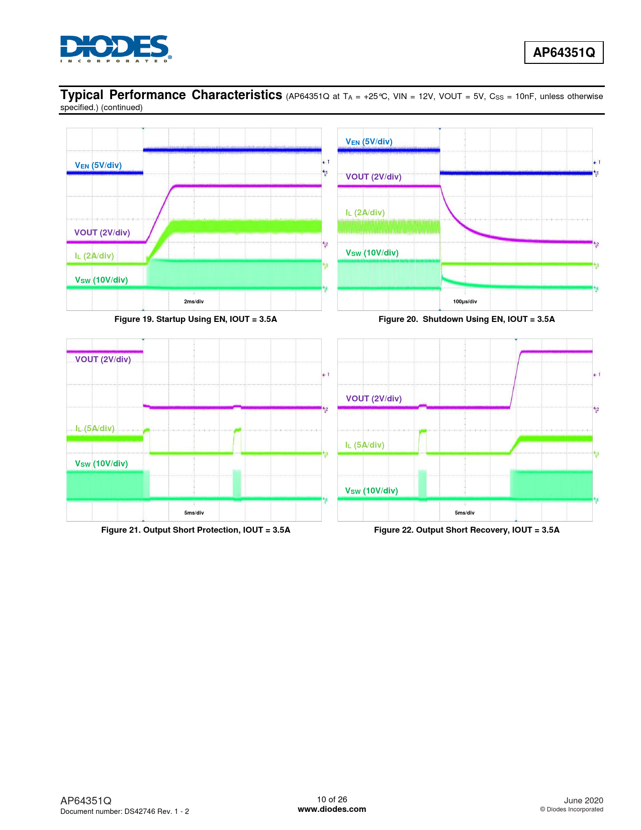

AP64351Q. Typical Performance Characteristics. VEN (5V/div). VOUT (2V/div). IL (2A/div). VSW (10V/div). L (2A/div). 2ms/div. 100μs/div
AP64351Q Typical Performance Characteristics VEN (5V/div) VOUT (2V/div) IL (2A/div) VSW (10V/div) L (2A/div) 2ms/div 100μs/div
(AP64351Q at TA = +25°C, VIN = 12V, VOUT = 5V, CSS = 10nF, unless otherwise specified.) (continued)
VEN (5V/div) VEN (5V/div) VOUT (2V/div) IL (2A/div) VOUT (2V/div) I VSW (10V/div) L (2A/div) VSW (10V/div) 2ms/div 100μs/div Figure 19. Startup Using EN, IOUT = 3.5A Figure 20. Shutdown Using EN, IOUT = 3.5A VOUT (2V/div) VOUT (2V/div) IL (5A/div) IL (5A/div) VSW (10V/div) VSW (10V/div) 5ms/div 5ms/div Figure 21. Output Short Protection, IOUT = 3.5A Figure 22. Output Short Recovery, IOUT = 3.5A
