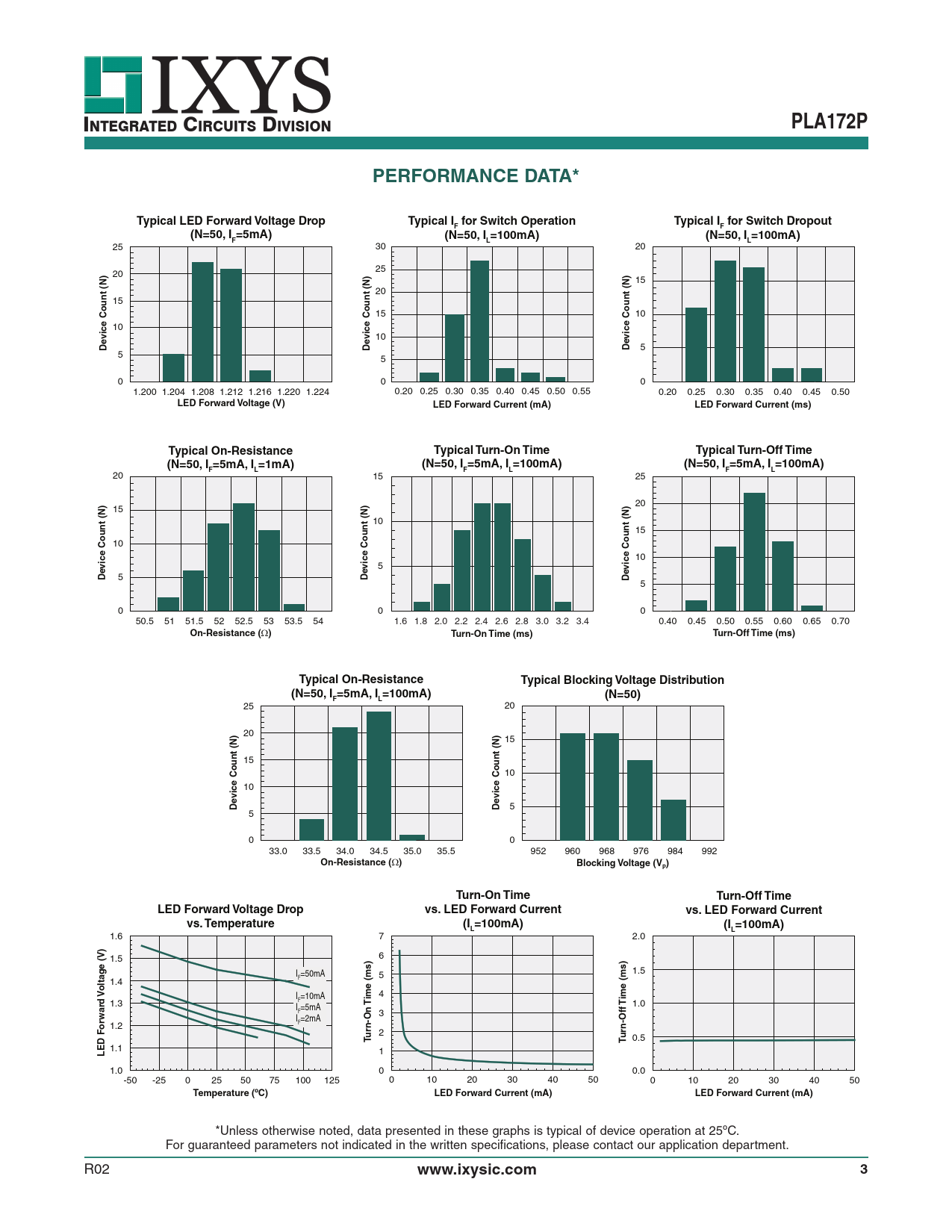

Description800V Normally-Open Single-Pole 6-Pin OptoMOS Relay

PLA172P. PERFORMANCE DATA*. Typical LED Forward Voltage Drop. Typical I for Switch Operation. Typical I for Switch Dropout
PLA172P PERFORMANCE DATA* Typical LED Forward Voltage Drop Typical I for Switch Operation Typical I for Switch Dropout
INTEGRATED CIRCUITS DIVISION
PLA172P PERFORMANCE DATA* Typical LED Forward Voltage Drop Typical I for Switch Operation Typical I for Switch Dropout F F (N=50, I =5mA) (N=50, I =100mA) (N=50, I =100mA) F L L

5 5 5 0 0 0 1.200 1.204 1.208 1.212 1.216 1.220 1.224 0.20 0.25 0.30 0.35 0.40 0.45 0.50 0.55 0.20 0.25 0.30 0.35 0.40 0.45 0.50
LED Forward Voltage (V) LED Forward Current (mA) LED Forward Current (ms) Typical On-Resistance Typical Turn-On Time Typical Turn-Off Time (N=50, I =5mA, I =1mA) (N=50, I =5mA, I =100mA) (N=50, I =5mA, I =100mA) F L F L F L

5 0 0 0 50.5 51 51.5 52 52.5 53 53.5 54 1.6 1.8 2.0 2.2 2.4 2.6 2.8 3.0 3.2 3.4 0.40 0.45 0.50 0.55 0.60 0.65 0.70
On-Resistance (
) Turn-On Time (ms) Turn-Off Time (ms) Typical On-Resistance Typical Blocking Voltage Distribution (N=50, I =5mA, I =100mA) (N=50) F L

5 5 0 0 33.0 33.5 34.0 34.5 35.0 35.5 952 960 968 976 984 992
On-Resistance (
) Blocking Voltage (V ) P Turn-On Time Turn-Off Time LED Forward Voltage Drop vs. LED Forward Current vs. LED Forward Current vs. Temperature (I =100mA) (I =100mA) L L

1.0 0 0.0 -50 -25 0 25 50 75 100 125 0 10 20 30 40 50 0 10 20 30 40 50
Temperature (ºC) LED Forward Current (mA) LED Forward Current (mA)
*Unless otherwise noted, data presented in these graphs is typical of device operation at 25ºC. For guaranteed parameters not indicated in the written specifications, please contact our application department. R02
