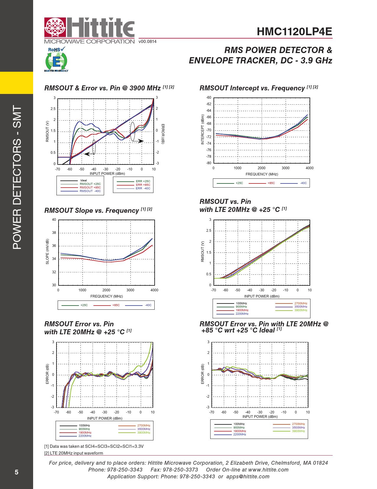

HMC1120LP4E. RMS POWER DETECTOR &. ENVELOPE TRACKER, DC - 3.9 GHz. RMSOUT & Error vs. Pin @ 3900 MHz [1] [2]
![HMC1120LP4E RMS POWER DETECTOR & ENVELOPE TRACKER, DC - 3.9 GHz RMSOUT & Error vs Pin @ 3900 MHz [1] [2]](https://www.rlocman.ru/datasheet/img.php?di=169259&p=6)
HMC1120LP4E
v00.0814
RMS POWER DETECTOR & ENVELOPE TRACKER, DC - 3.9 GHz RMSOUT & Error vs. Pin @ 3900 MHz [1] [2] RMSOUT intercept vs. Frequency [1] [2]
3 3 -60 T -62 2.5 2 -64 M -66 2 1 S ERROR (dB) -68 - 1.5 0 -70 -72 RMSOUT (V) 1 -1 RS INTERCEPT (dBm) -74 -76 O 0.5 -2 -78 T 0 -3 -80 C -70 -60 -50 -40 -30 -20 -10 0 10 0 1000 2000 3000 4000 E INPUT POWER (dBm) FREQUENCY (MHz) T Ideal ERR +25C RMSOUT +25C ERR +85C +25C +85C -40C E RMSOUT +85C ERR -40C RMSOUT -40C D
RMSOUT vs. Pin
R
RMSOUT Slope vs. Frequency [1] [2] with LTE 20MHz @ +25 °C [1]
E 40 3 W 2.5 O 38 P 2 36 1.5 34 SLOPE (mV/dB) RMSOUT (V) 1 32 0.5 30 0 0 1000 2000 3000 4000 -70 -60 -50 -40 -30 -20 -10 0 10 FREQUENCY (MHz) INPUT POWER (dBm) +25C +85C -40C 100MHz 2700MHz 900MHz 3500MHz 1900MHz 3900MHz 2200MHz
RMSOUT Error vs. Pin RMSOUT Error vs. Pin with LTE 20MHz @ with LTE 20MHz @ +25 °C [1] +85 °C wrt +25 °C ideal [1]
3 3 2 2 1 1 0 0 ERROR (dB) ERROR (dB) -1 -1 -2 -2 -3 -3 -70 -60 -50 -40 -30 -20 -10 0 10 -70 -60 -50 -40 -30 -20 -10 0 10 INPUT POWER (dBm) INPUT POWER (dBm) 100MHz 2700MHz 100MHz 2700MHz 900MHz 3500MHz 900MHz 3500MHz 1900MHz 3900MHz 1900MHz 3900MHz 2200MHz 2200MHz [1] Data was taken at SCI4=SCI3=SCI2=SCI1=3.3V [2] LTE 20MHz input waveform For price, delivery and to place orders: Hittite Microwave Corporation, 2 Elizabeth Drive, Chelmsford, MA 01824 Phone: 978-250-3343 Fax: 978-250-3373 Order On-line at www.hittite.com
