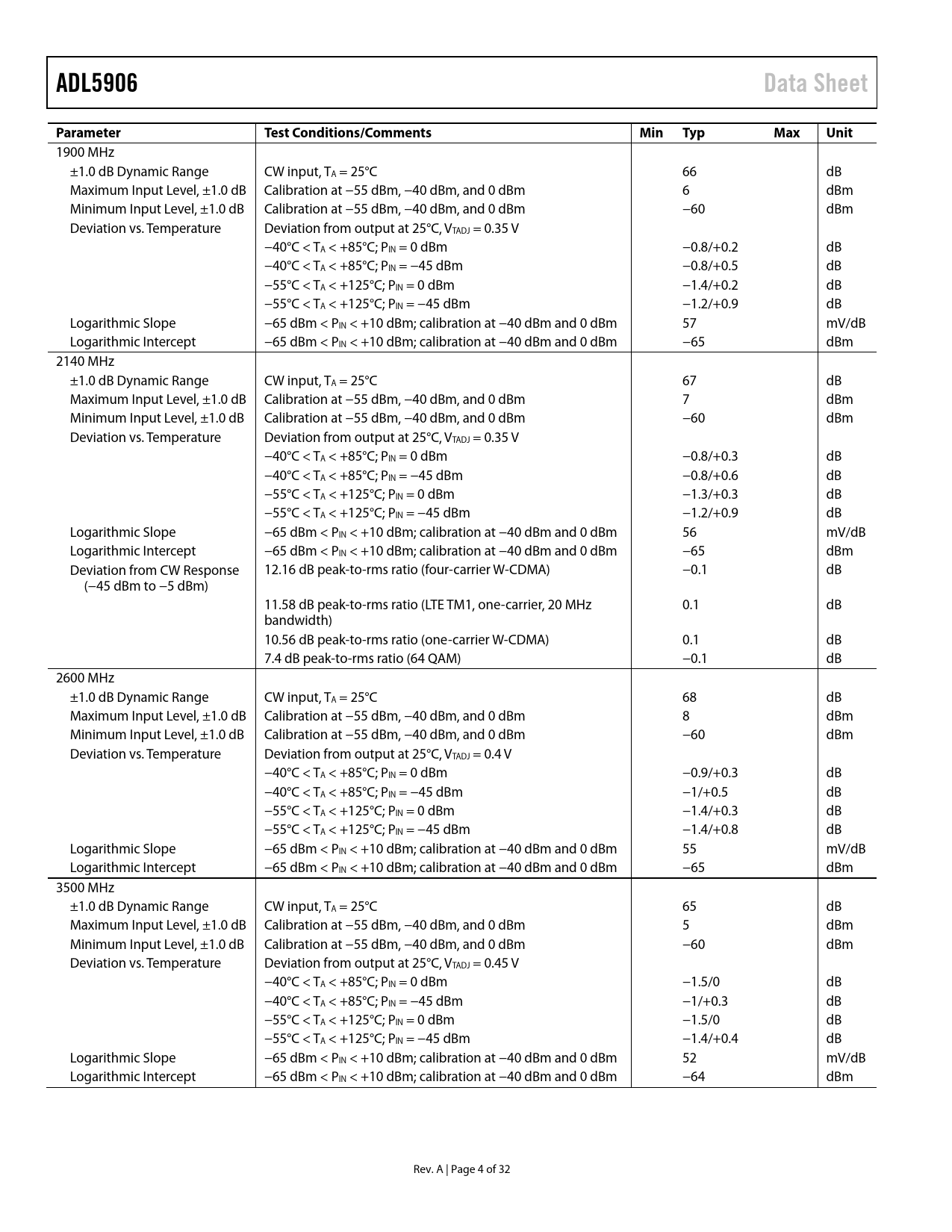

ADL5906. Data Sheet. Parameter. Test Conditions/Comments. Min. Typ. Max. Unit
ADL5906 Data Sheet Parameter Test Conditions/Comments Min Typ Max Unit
1900 MHz ±1.0 dB Dynamic Range CW input, TA = 25°C 66 dB Maximum Input Level, ±1.0 dB Calibration at −55 dBm, −40 dBm, and 0 dBm 6 dBm Minimum Input Level, ±1.0 dB Calibration at −55 dBm, −40 dBm, and 0 dBm −60 dBm Deviation vs. Temperature Deviation from output at 25°C, VTADJ = 0.35 V −40°C < TA < +85°C; PIN = 0 dBm −0.8/+0.2 dB −40°C < TA < +85°C; PIN = −45 dBm −0.8/+0.5 dB −55°C < TA < +125°C; PIN = 0 dBm −1.4/+0.2 dB −55°C < TA < +125°C; PIN = −45 dBm −1.2/+0.9 dB Logarithmic Slope −65 dBm < PIN < +10 dBm; calibration at −40 dBm and 0 dBm 57 mV/dB Logarithmic Intercept −65 dBm < PIN < +10 dBm; calibration at −40 dBm and 0 dBm −65 dBm 2140 MHz ±1.0 dB Dynamic Range CW input, TA = 25°C 67 dB Maximum Input Level, ±1.0 dB Calibration at −55 dBm, −40 dBm, and 0 dBm 7 dBm Minimum Input Level, ±1.0 dB Calibration at −55 dBm, −40 dBm, and 0 dBm −60 dBm Deviation vs. Temperature Deviation from output at 25°C, VTADJ = 0.35 V −40°C < TA < +85°C; PIN = 0 dBm −0.8/+0.3 dB −40°C < TA < +85°C; PIN = −45 dBm −0.8/+0.6 dB −55°C < TA < +125°C; PIN = 0 dBm −1.3/+0.3 dB −55°C < TA < +125°C; PIN = −45 dBm −1.2/+0.9 dB Logarithmic Slope −65 dBm < PIN < +10 dBm; calibration at −40 dBm and 0 dBm 56 mV/dB Logarithmic Intercept −65 dBm < PIN < +10 dBm; calibration at −40 dBm and 0 dBm −65 dBm Deviation from CW Response 12.16 dB peak-to-rms ratio (four-carrier W-CDMA) −0.1 dB (−45 dBm to −5 dBm) 11.58 dB peak-to-rms ratio (LTE TM1, one-carrier, 20 MHz 0.1 dB bandwidth) 10.56 dB peak-to-rms ratio (one-carrier W-CDMA) 0.1 dB 7.4 dB peak-to-rms ratio (64 QAM) −0.1 dB 2600 MHz ±1.0 dB Dynamic Range CW input, TA = 25°C 68 dB Maximum Input Level, ±1.0 dB Calibration at −55 dBm, −40 dBm, and 0 dBm 8 dBm Minimum Input Level, ±1.0 dB Calibration at −55 dBm, −40 dBm, and 0 dBm −60 dBm Deviation vs. Temperature Deviation from output at 25°C, VTADJ = 0.4 V −40°C < TA < +85°C; PIN = 0 dBm −0.9/+0.3 dB −40°C < TA < +85°C; PIN = −45 dBm −1/+0.5 dB −55°C < TA < +125°C; PIN = 0 dBm −1.4/+0.3 dB −55°C < TA < +125°C; PIN = −45 dBm −1.4/+0.8 dB Logarithmic Slope −65 dBm < PIN < +10 dBm; calibration at −40 dBm and 0 dBm 55 mV/dB Logarithmic Intercept −65 dBm < PIN < +10 dBm; calibration at −40 dBm and 0 dBm −65 dBm 3500 MHz ±1.0 dB Dynamic Range CW input, TA = 25°C 65 dB Maximum Input Level, ±1.0 dB Calibration at −55 dBm, −40 dBm, and 0 dBm 5 dBm Minimum Input Level, ±1.0 dB Calibration at −55 dBm, −40 dBm, and 0 dBm −60 dBm Deviation vs. Temperature Deviation from output at 25°C, VTADJ = 0.45 V −40°C < TA < +85°C; PIN = 0 dBm −1.5/0 dB −40°C < TA < +85°C; PIN = −45 dBm −1/+0.3 dB −55°C < TA < +125°C; PIN = 0 dBm −1.5/0 dB −55°C < TA < +125°C; PIN = −45 dBm −1.4/+0.4 dB Logarithmic Slope −65 dBm < PIN < +10 dBm; calibration at −40 dBm and 0 dBm 52 mV/dB Logarithmic Intercept −65 dBm < PIN < +10 dBm; calibration at −40 dBm and 0 dBm −64 dBm Rev. A | Page 4 of 32 Document Outline Features Applications Functional Block Diagram General Description Table of Contents Revision History Specifications Absolute Maximum Ratings ESD Caution Pin Configuration and Function Descriptions Typical Performance Characteristics Theory of Operation Square Law Detector and Amplitude Target RF Input Interface Temperature Sensor Interface VREF Interface Temperature Compensation Interface Power-Down Interface VSET Interface Output Interface VTGT Interface Basis for Error Calculations Measurement Mode Basic Connections Setting VTADJ Setting VTGT Choosing a Value for CRMS Output Voltage Scaling System Calibration and Error Calculation Using VTEMP to Improve Intercept Temperature Drift Description of Characterization Evaluation Board Evaluation Board Assembly Drawings Outline Dimensions Ordering Guide
