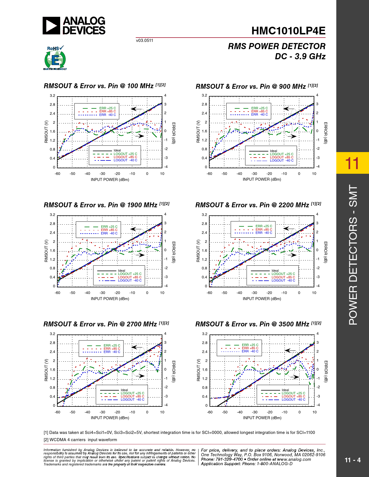

HMC1010LP4E. RMS POWER DETECTOR. DC - 3.9 GHz. RMSOUT & Error vs. Pin @ 100 MHz [1][2]
HMC1010LP4E RMS POWER DETECTOR DC - 3.9 GHz RMSOUT & Error vs Pin @ 100 MHz [1][2]
HMC1010LP4E
v03.0511
RMS POWER DETECTOR DC - 3.9 GHz RMSOUT & Error vs. Pin @ 100 MHz [1][2] RMSOUT & Error vs. Pin @ 900 MHz [1][2]
3.2 4 3.2 4 2.8 3 2.8 3 ERR +25 C ERR +25 C 2.4 ERR +85 C 2 ERR +85 C 2 ERR -40 C 2.4 ERR -40 C 2 1 ERROR 1 ERROR (V) 2 (V) 1.6 0 1.6 0 (dB) (dB) 1.2 -1 RMSOUT 1.2 -1 RMSOUT 0.8 -2 -2 Ideal 0.8 Ideal LOGOUT +25 C LOGOUT +25 C 0.4 LOGOUT +85 C -3 0.4 LOGOUT +85 C -3 LOGOUT -40 C LOGOUT -40 C 0 -4 0 -4 11 -60 -50 -40 -30 -20 -10 0 10 -60 -50 -40 -30 -20 -10 0 10 INPUT POWER (dBm) INPUT POWER (dBm) t M
RMSOUT & Error vs. Pin @ 1900 MHz [1][2] RMSOUT & Error vs. Pin @ 2200 MHz [1][2]
s 3.2 4 3.2 4 - 2.8 3 2.8 3 ERR +25 C ERR +25 C ERR +85 C ERR +85 C 2.4 2 2.4 ERR -40 C 2 rs ERR -40 C 1 ERROR 1 ERROR o 2 (V) 2 (V) t 1.6 0 1.6 0 (dB) (dB) c 1.2 -1 RMSOUT 1.2 -1 RMSOUT e 0.8 -2 0.8 -2 t Ideal Ideal LOGOUT +25 C LOGOUT +25 C e 0.4 LOGOUT +85 C -3 0.4 LOGOUT +85 C -3 LOGOUT -40 C LOGOUT -40 C 0 -4 0 -4 D -60 -50 -40 -30 -20 -10 0 10 -60 -50 -40 -30 -20 -10 0 10 r INPUT POWER (dBm) INPUT POWER (dBm) e w o
RMSOUT & Error vs. Pin @ 2700 MHz [1][2] RMSOUT & Error vs. Pin @ 3500 MHz [1][2]
P 3.2 4 3.2 4 2.8 3 2.8 3 ERR +25 C ERR +25 C ERR +85 C ERR +85 C 2.4 ERR -40 C 2 2.4 ERR -40 C 2 2 1 ERROR 1 ERROR (V) 2 (V) 1.6 0 1.6 0 (dB) (dB) 1.2 -1 RMSOUT 1.2 -1 RMSOUT 0.8 -2 0.8 -2 Ideal Ideal LOGOUT +25 C LOGOUT +25 C 0.4 LOGOUT +85 C -3 0.4 LOGOUT +85 C -3 LOGOUT -40 C LOGOUT -40 C 0 -4 0 -4 -60 -50 -40 -30 -20 -10 0 10 -60 -50 -40 -30 -20 -10 0 10 INPUT POWER (dBm) INPUT POWER (dBm) [1] Data was taken at sci4=sci1=0V, sci3=sci2=5V, shortest integration time is for scI=0000, allowed longest integration time is for scI=1100 [2] wcDMA 4 carriers input waveform Info F rmoatr p ion rfiurcne is , d hed ebly ivAe n r al y a og D n evd t ice o p s is bla eli c eve o ed t rd o b e e ras: H ccuratite tiatne M d reli iac bl reo . w Ho av wev e C er, n o o For price, delivery, and to place orders: Analog Devices, Inc., responsibility is assumed by Analog Devices for its use, nor for any infringements of patents or other rporation, 20 Alpha Road, Chelmsford, MA 01824 One Technology Way, P.O. Box 9106, Norwood, MA 02062-9106 Phone: 978-250-3343 Fax: 978-250-3373 O rights of third parties that may result from its use. Specifications subject to change without notice. No P rd ho e ne r O : 7 n 81- -3li 2n 9 e a -47 t w 0 w 0 • O w rd .h e it r o tniltie n .c e ao t m license is granted by implication or otherwise under any patent or patent rights of Analog Devices. www.analog.com
