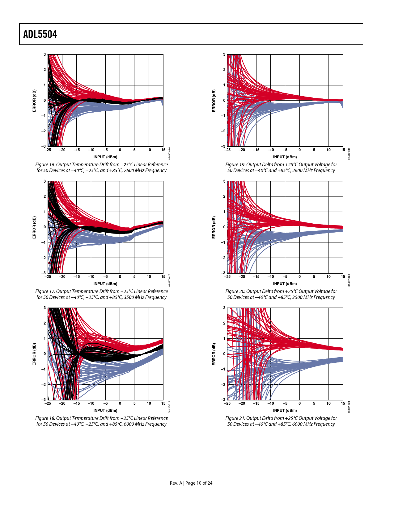

ADL5504 3 3 2 2 1 1 B) B) d d R ( 0 R ( 0 RRO RRO E E –1 –1 –2 –2 –3 –3 –25 –20 –15 –10 –5 0 5 10 15
016
019
INPUT (dBm) INPUT (dBm)
08437- 08437- Figure 16. Output Temperature Drift from +25°C Linear Reference Figure 19. Output Delta from +25°C Output Voltage for for 50 Devices at −40°C, +25°C, and +85°C, 2600 MHz Frequency 50 Devices at −40°C and +85°C, 2600 MHz Frequency
017
020
08437- 08437- Figure 17. Output Temperature Drift from +25°C Linear Reference Figure 20. Output Delta from +25°C Output Voltage for for 50 Devices at −40°C, +25°C, and +85°C, 3500 MHz Frequency 50 Devices at −40°C and +85°C, 3500 MHz Frequency
018
021
08437- 08437- Figure 18. Output Temperature Drift from +25°C Linear Reference Figure 21. Output Delta from +25°C Output Voltage for for 50 Devices at −40°C, +25°C, and +85°C, 6000 MHz Frequency 50 Devices at −40°C and +85°C, 6000 MHz Frequency Rev. A | Page 10 of 24 Document Outline Features Applications Functional Block Diagram General Description Revision History Specifications Absolute Maximum Ratings ESD Caution Pin Configuration and Function Descriptions Typical Performance Characteristics Circuit Description RMS Circuit Description and Filtering Filtering Output Buffer Applications Information Basic Connections RF Input Interfacing Resistive Tap RF Input Multiple RF Inputs Linearity Output Swing Output Offset Output Drive Capability and Buffering Selecting the Square-Domain Filter and Output Low-Pass Filter Power Consumption, Enable, and Power-On/Power-Off Response Time Device Calibration and Error Calculation Calibration for Improved Accuracy Drift over a Reduced Temperature Range Device Handling Evaluation Board Land Pattern and Soldering Information Outline Dimensions Ordering Guide
