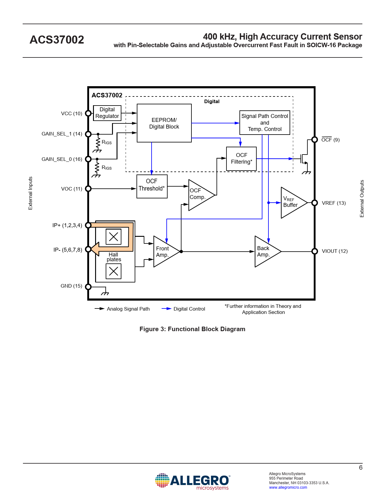

400 kHz, High Accuracy Current Sensor ACS37002 with Pin-Selectable Gains and Adjustable Overcurrent Fast Fault in SOICW-16 Package ACS37002 Digital
Digital VCC (10) Regulator Signal Path Control EEPROM/ and Digital Block Temp. Control GAIN_SEL_1 (14) OCF (9) RIGS OCF GAIN_SEL_0 (16) Filtering* RIGS OCF VOC (11) Threshold* OCF Comp. VREF Buffer VREF (13) External Inputs External Outputs IP+ (1,2,3,4) IP- (5,6,7,8) Front Back Hall VIOUT (12) Amp. Amp. plates GND (15) Analog Signal Path Digital Control *Further information in Theory and Application Section
Figure 3: Functional Block Diagram
