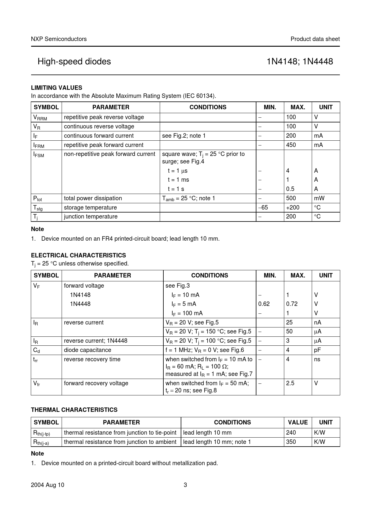

LIMITING VALUES
In accordance with the Absolute Maximum Rating System (IEC 60134).
SYMBOL PARAMETER CONDITIONS MIN. MAX. UNIT
VRRM repetitive peak reverse voltage − 100 V VR continuous reverse voltage − 100 V IF continuous forward current see Fig.2; note 1 − 200 mA IFRM repetitive peak forward current − 450 mA IFSM non-repetitive peak forward current square wave; Tj = 25 °C prior to surge; see Fig.4 t = 1 µs − 4 A t = 1 ms − 1 A t = 1 s − 0.5 A Ptot total power dissipation Tamb = 25 °C; note 1 − 500 mW Tstg storage temperature −65 +200 °C Tj junction temperature − 200 °C
Note
1. Device mounted on an FR4 printed-circuit board; lead length 10 mm.
ELECTRICAL CHARACTERISTICS
Tj = 25 °C unless otherwise specified.
VF forward voltage see Fig.3 1N4148 IF = 10 mA − 1 V 1N4448 IF = 5 mA 0.62 0.72 V IF = 100 mA − 1 V IR reverse current VR = 20 V; see Fig.5 25 nA VR = 20 V; Tj = 150 °C; see Fig.5 − 50 µA IR reverse current; 1N4448 VR = 20 V; Tj = 100 °C; see Fig.5 − 3 µA Cd diode capacitance f = 1 MHz; VR = 0 V; see Fig.6 − 4 pF t − rr reverse recovery time when switched from IF = 10 mA to 4 ns IR = 60 mA; RL = 100 Ω; measured at IR = 1 mA; see Fig.7 V − fr forward recovery voltage when switched from IF = 50 mA; 2.5 V tr = 20 ns; see Fig.8
THERMAL CHARACTERISTICS SYMBOL PARAMETER CONDITIONS VALUE UNIT
Rth(j-tp) thermal resistance from junction to tie-point lead length 10 mm 240 K/W Rth(j-a) thermal resistance from junction to ambient lead length 10 mm; note 1 350 K/W
