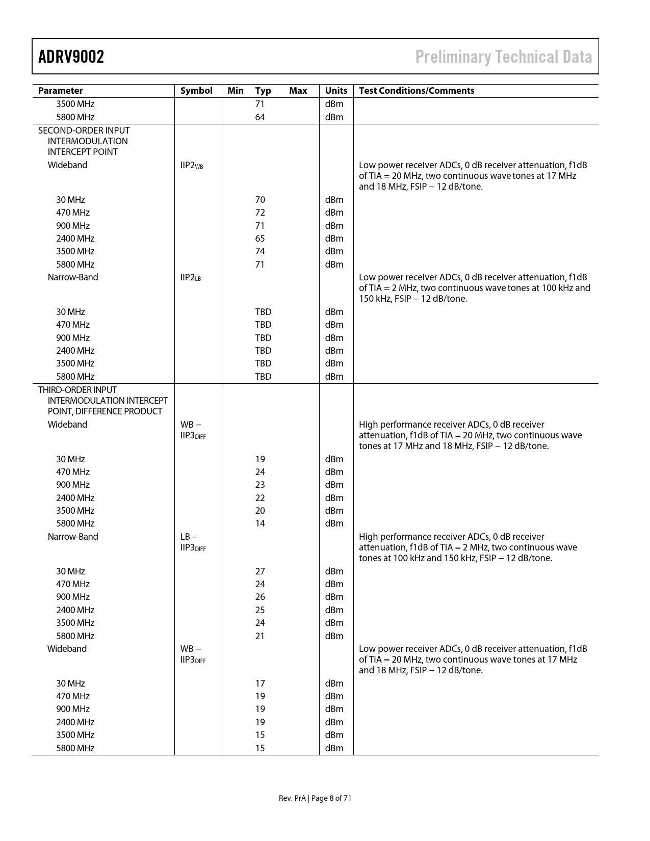

ADRV9002. Preliminary Technical Data. Parameter. Symbol Min. Typ Max Units. Test. Conditions/Comments
ADRV9002 Preliminary Technical Data Parameter Symbol Min Typ Max Units Test Conditions/Comments
3500 MHz 71 dBm 5800 MHz 64 dBm SECOND-ORDER INPUT INTERMODULATION INTERCEPT POINT Wideband IIP2WB Low power receiver ADCs, 0 dB receiver attenuation, f1dB of TIA = 20 MHz, two continuous wave tones at 17 MHz and 18 MHz, FSIP − 12 dB/tone. 30 MHz 70 dBm 470 MHz 72 dBm 900 MHz 71 dBm 2400 MHz 65 dBm 3500 MHz 74 dBm 5800 MHz 71 dBm Narrow-Band IIP2LB Low power receiver ADCs, 0 dB receiver attenuation, f1dB of TIA = 2 MHz, two continuous wave tones at 100 kHz and 150 kHz, FSIP − 12 dB/tone. 30 MHz TBD dBm 470 MHz TBD dBm 900 MHz TBD dBm 2400 MHz TBD dBm 3500 MHz TBD dBm 5800 MHz TBD dBm THIRD-ORDER INPUT INTERMODULATION INTERCEPT POINT, DIFFERENCE PRODUCT Wideband WB − High performance receiver ADCs, 0 dB receiver IIP3DIFF attenuation, f1dB of TIA = 20 MHz, two continuous wave tones at 17 MHz and 18 MHz, FSIP − 12 dB/tone. 30 MHz 19 dBm 470 MHz 24 dBm 900 MHz 23 dBm 2400 MHz 22 dBm 3500 MHz 20 dBm 5800 MHz 14 dBm Narrow-Band LB − High performance receiver ADCs, 0 dB receiver IIP3DIFF attenuation, f1dB of TIA = 2 MHz, two continuous wave tones at 100 kHz and 150 kHz, FSIP − 12 dB/tone. 30 MHz 27 dBm 470 MHz 24 dBm 900 MHz 26 dBm 2400 MHz 25 dBm 3500 MHz 24 dBm 5800 MHz 21 dBm Wideband WB − Low power receiver ADCs, 0 dB receiver attenuation, f1dB IIP3DIFF of TIA = 20 MHz, two continuous wave tones at 17 MHz and 18 MHz, FSIP − 12 dB/tone. 30 MHz 17 dBm 470 MHz 19 dBm 900 MHz 19 dBm 2400 MHz 19 dBm 3500 MHz 15 dBm 5800 MHz 15 dBm Rev. PrA | Page 8 of 71 Document Outline FEATURES APPLICATIONS GENERAL DESCRIPTION TABLE OF CONTENTS FUNCTIONAL BLOCK DIAGRAM SPECIFICATIONS TRANSMITTER SPECIFICATIONS RECEIVER SPECIFICATIONS INTERNAL LO, EXTERNAL LO, AND DEVICE CLOCK DIGITAL INTERFACES AND AUXILIARY CONVERTERS POWER SUPPLY SPECIFICATIONS CURRENT CONSUMPTION ESTIMATES (TYPICAL VALUES) Sleep Mode (Typical Values) TDD Operation (Typical Values) FDD Operation (Typical Values) TIMING SPECIFICATIONS ABSOLUTE MAXIMUM RATINGS REFLOW PROFILE THERMAL RESISTANCE ELECTROSTATIC DISCHARGE (ESD) RATINGS ESD Ratings for ADRV2009 ESD CAUTION PIN CONFIGURATION AND FUNCTION DESCRIPTIONS TYPICAL PERFORMANCE CHARACTERISTICS 30 MHZ BAND 470 MHZ BAND 900 MHZ BAND 2400 MHZ BAND 3500 MHZ BAND 5800 MHZ BAND PHASE NOISE THEORY OF OPERATION TRANSMITTER RECEIVER Monitor Mode DPD Receiver as an Observation Receiver CLOCK INPUT SYNTHESIZERS RF PLL Baseband PLL (PLL) SPI INTERFACE GPIO PINS Digital GPIO Inputs/Outputs (DGPIO) Analog GPIO Inputs/Outputs (AGPIO) AUXILLARY CONVERTERS Auxiliary ADC Inputs (AUXADC_x) Auxiliary DACs Outputs (AUXDAC_x) JTAG BOUNDARY SCAN APPLICATIONS INFORMATION POWER SUPPLY SEQUENCE DIGITAL DATA INTERFACE CSSI CSSI Receive CSSI Transmit LSSI OUTLINE DIMENSIONS
