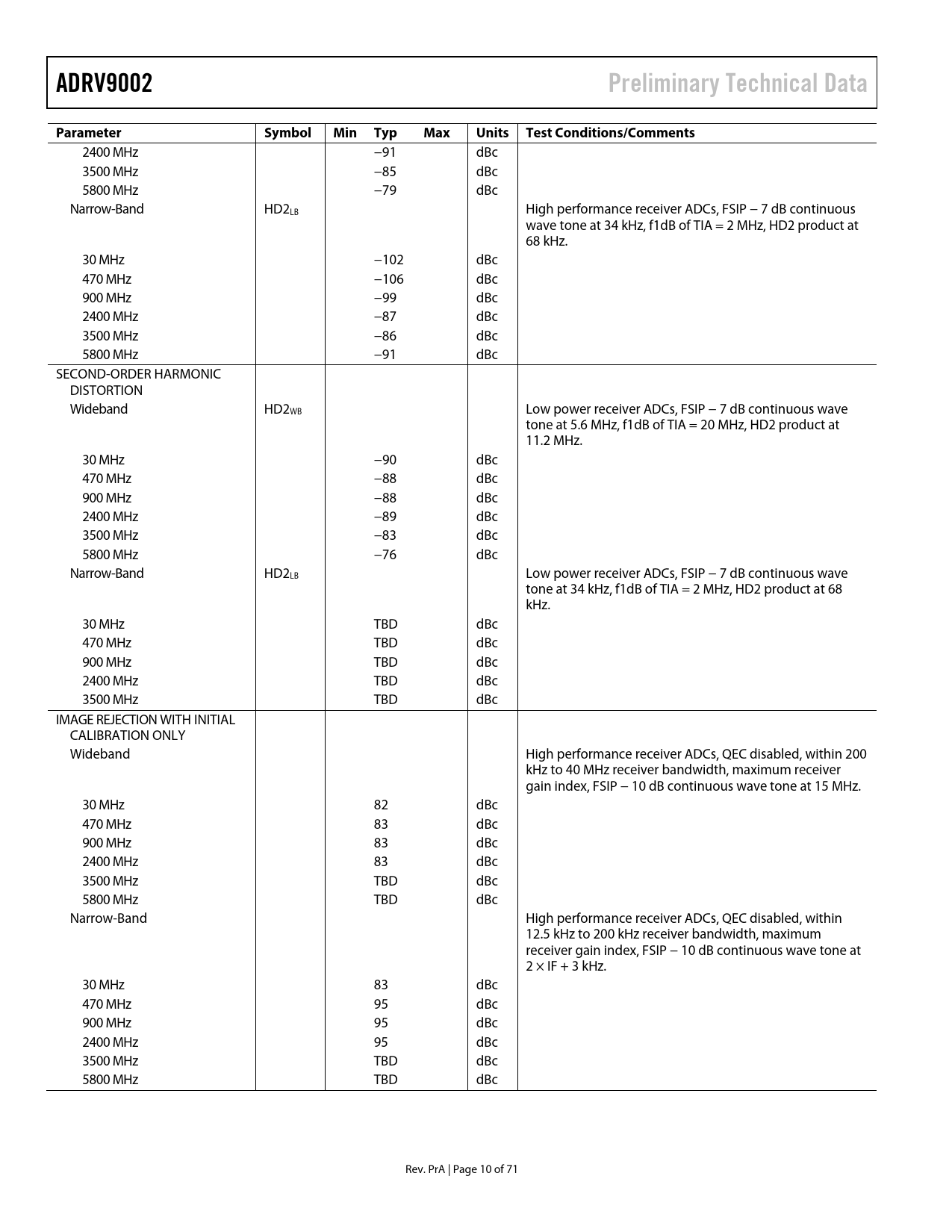

ADRV9002. Preliminary Technical Data. Parameter. Symbol Min. Typ Max Units. Test. Conditions/Comments
ADRV9002 Preliminary Technical Data Parameter Symbol Min Typ Max Units Test Conditions/Comments
2400 MHz −91 dBc 3500 MHz −85 dBc 5800 MHz −79 dBc Narrow-Band HD2LB High performance receiver ADCs, FSIP − 7 dB continuous wave tone at 34 kHz, f1dB of TIA = 2 MHz, HD2 product at 68 kHz. 30 MHz −102 dBc 470 MHz −106 dBc 900 MHz −99 dBc 2400 MHz −87 dBc 3500 MHz −86 dBc 5800 MHz −91 dBc SECOND-ORDER HARMONIC DISTORTION Wideband HD2WB Low power receiver ADCs, FSIP − 7 dB continuous wave tone at 5.6 MHz, f1dB of TIA = 20 MHz, HD2 product at 11.2 MHz. 30 MHz −90 dBc 470 MHz −88 dBc 900 MHz −88 dBc 2400 MHz −89 dBc 3500 MHz −83 dBc 5800 MHz −76 dBc Narrow-Band HD2LB Low power receiver ADCs, FSIP − 7 dB continuous wave tone at 34 kHz, f1dB of TIA = 2 MHz, HD2 product at 68 kHz. 30 MHz TBD dBc 470 MHz TBD dBc 900 MHz TBD dBc 2400 MHz TBD dBc 3500 MHz TBD dBc IMAGE REJECTION WITH INITIAL CALIBRATION ONLY Wideband High performance receiver ADCs, QEC disabled, within 200 kHz to 40 MHz receiver bandwidth, maximum receiver gain index, FSIP − 10 dB continuous wave
tone at 15 MHz. 30 MHz 82 dBc 470 MHz 83 dBc 900 MHz 83 dBc 2400 MHz 83 dBc 3500 MHz TBD dBc 5800 MHz TBD dBc Narrow-Band High performance receiver ADCs, QEC disabled, within 12.5 kHz to 200 kHz receiver bandwidth, maximum receiver gain index, FSIP − 10 dB continuous wave tone at 2 × IF + 3 kHz. 30 MHz 83 dBc 470 MHz 95 dBc 900 MHz 95 dBc 2400 MHz 95 dBc 3500 MHz TBD dBc 5800 MHz TBD dBc Rev. PrA | Page 10 of 71 Document Outline FEATURES APPLICATIONS GENERAL DESCRIPTION TABLE OF CONTENTS FUNCTIONAL BLOCK DIAGRAM SPECIFICATIONS TRANSMITTER SPECIFICATIONS RECEIVER SPECIFICATIONS INTERNAL LO, EXTERNAL LO, AND DEVICE CLOCK DIGITAL INTERFACES AND AUXILIARY CONVERTERS POWER SUPPLY SPECIFICATIONS CURRENT CONSUMPTION ESTIMATES (TYPICAL VALUES) Sleep Mode (Typical Values) TDD Operation (Typical Values) FDD Operation (Typical Values) TIMING SPECIFICATIONS ABSOLUTE MAXIMUM RATINGS REFLOW PROFILE THERMAL RESISTANCE ELECTROSTATIC DISCHARGE (ESD) RATINGS ESD Ratings for ADRV2009 ESD CAUTION PIN CONFIGURATION AND FUNCTION DESCRIPTIONS TYPICAL PERFORMANCE CHARACTERISTICS 30 MHZ BAND 470 MHZ BAND 900 MHZ BAND 2400 MHZ BAND 3500 MHZ BAND 5800 MHZ BAND PHASE NOISE THEORY OF OPERATION TRANSMITTER RECEIVER Monitor Mode DPD Receiver as an Observation Receiver CLOCK INPUT SYNTHESIZERS RF PLL Baseband PLL (PLL) SPI INTERFACE GPIO PINS Digital GPIO Inputs/Outputs (DGPIO) Analog GPIO Inputs/Outputs (AGPIO) AUXILLARY CONVERTERS Auxiliary ADC Inputs (AUXADC_x) Auxiliary DACs Outputs (AUXDAC_x) JTAG BOUNDARY SCAN APPLICATIONS INFORMATION POWER SUPPLY SEQUENCE DIGITAL DATA INTERFACE CSSI CSSI Receive CSSI Transmit LSSI OUTLINE DIMENSIONS
