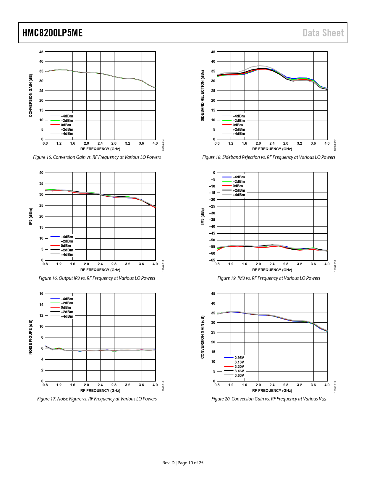

HMC8200LP5ME. Data Sheet. Bc). N (. N ( AI. N G. RS E NV. BAND RE. –4dBm. IDE. –2dBm. 0dBm. +2dBm. +4dBm. 0.8. 1.2. 1.6. 2.0. 2.4. 2.8. 3.2. 3.6. 4.0
HMC8200LP5ME Data Sheet Bc) N ( N ( AI N G RS E NV BAND RE –4dBm IDE –2dBm 0dBm +2dBm +4dBm 0.8 1.2 1.6 2.0 2.4 2.8 3.2 3.6 4.0
HMC8200LP5ME Data Sheet 45 45 40 40 35 35 Bc) B) d d 30 N ( 30 N ( AI IO 25 CT 25 N G JE IO 20 20 RS E NV 15 BAND RE 15 CO –4dBm IDE –4dBm 10 –2dBm S 10 –2dBm 0dBm 0dBm 5 +2dBm 5 +2dBm +4dBm +4dBm 0 0 0.8 1.2 1.6 2.0 2.4 2.8 3.2 3.6 4.0

13868- Figure 15. Conversion Gain vs. RF Frequency at Various LO Powers Figure 18. Sideband Rejection vs. RF Frequency at Various LO Powers

13868- Figure 16. Output IP3 vs. RF Frequency at Various LO Powers Figure 19. IM3 vs. RF Frequency at Various LO Powers
16 45 –4dBm 14 –2dBm 40 0dBm +2dBm 35 12 +4dBm ) B) d 30 dB ( 10 N ( E AI R 25 8 N G IO FIGU 20 E RS 6 E OIS N NV 15 4 CO 2.95V 10 3.13V 3.30V 2 5 3.46V 3.63V 0 0 0.8 1.2 1.6 2.0 2.4 2.8 3.2 3.6 4.0

13868- Figure 17. Noise Figure vs. RF Frequency at Various LO Powers Figure 20. Conversion Gain vs. RF Frequency at Various VCCx Rev. D | Page 10 of 25 Document Outline Features Applications Functional Block Diagram General Description Revision History Specifications Electrical Characteristics: 800 MHz to 1800 MHz RF Frequency Range Electrical Characteristics: 1800 MHz to 2800 MHz RF Frequency Range Electrical Characteristics: 2800 MHz to 4000 MHz RF Frequency Range Absolute Maximum Ratings ESD Caution Pin Configuration and Function Descriptions Typical Performance Characteristics Theory of Operation Register Array Assignments and Serial Interface Read Example Register Descriptions Register Array Assignments Enable Bits Digital Gain Amplifier: DGA Control Digital Gain Amplifier: Amplifier Current, Envelope Level, and VGA Attenuation Bias Image Reject Mixer: Sideband, and Polarity and Offset for I Image Reject Mixer: Polarity and Offset for Q Phase I: Adjust Phase Q: Adjust Evaluation Printed Circuit Board (PCB) Evaluation PCB Schematic Outline Dimensions Ordering Guide
