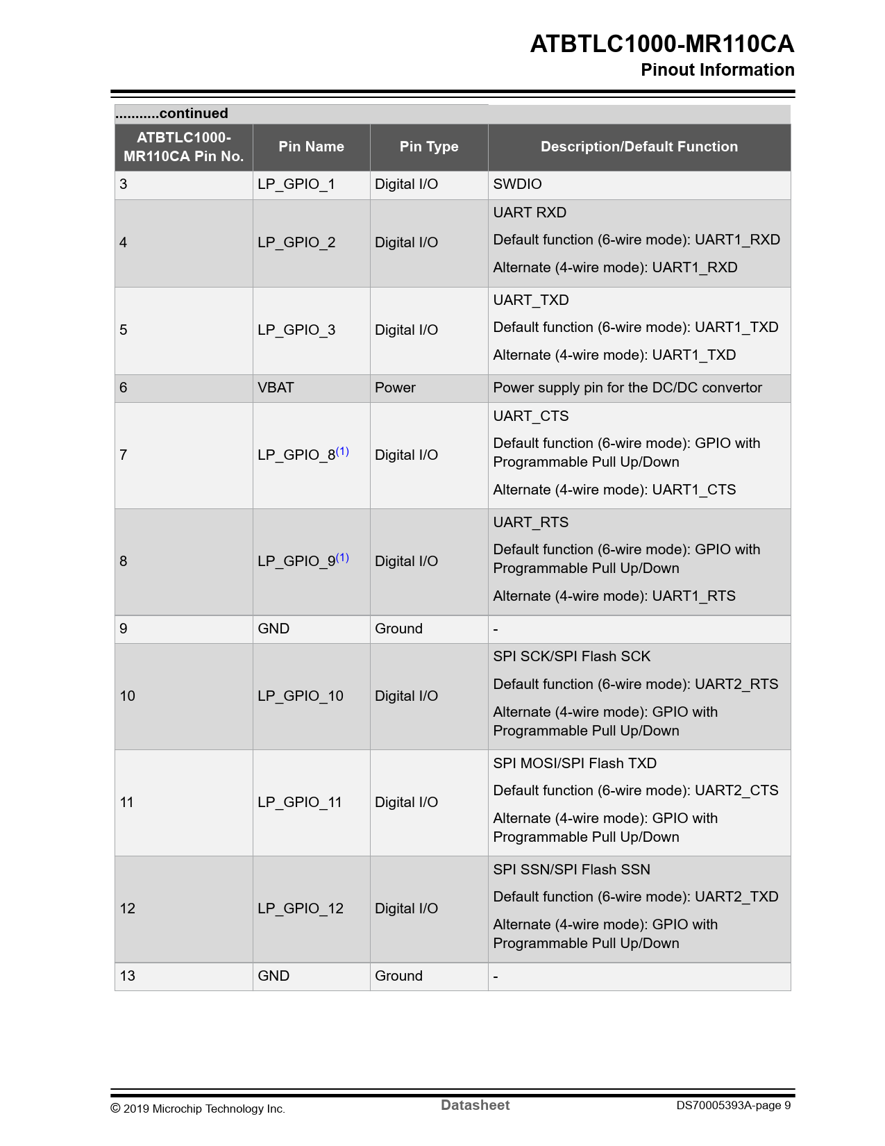

ATBTLC1000-MR110CA. Pinout Information. ...continued. ATBTLC1000-. Pin Name. Pin Type. Description/Default Function. MR110CA Pin No
link to page 10 link to page 10
ATBTLC1000-MR110CA Pinout Information ...continued ATBTLC1000- Pin Name Pin Type Description/Default Function MR110CA Pin No.
3 LP_GPIO_1 Digital I/O SWDIO UART RXD 4 LP_GPIO_2 Digital I/O Default function (6-wire mode): UART1_RXD Alternate (4-wire mode): UART1_RXD UART_TXD 5 LP_GPIO_3 Digital I/O Default function (6-wire mode): UART1_TXD Alternate (4-wire mode): UART1_TXD 6 VBAT Power Power supply pin for the DC/DC convertor UART_CTS Default function (6-wire mode): GPIO with 7 LP_GPIO_8(1) Digital I/O Programmable Pull Up/Down Alternate (4-wire mode): UART1_CTS UART_RTS Default function (6-wire mode): GPIO with 8 LP_GPIO_9(1) Digital I/O Programmable Pull Up/Down Alternate (4-wire mode): UART1_RTS 9 GND Ground - SPI SCK/SPI Flash SCK Default function (6-wire mode): UART2_RTS 10 LP_GPIO_10 Digital I/O Alternate (4-wire mode): GPIO with Programmable Pull Up/Down SPI MOSI/SPI Flash TXD Default function (6-wire mode): UART2_CTS 11 LP_GPIO_11 Digital I/O Alternate (4-wire mode): GPIO with Programmable Pull Up/Down SPI SSN/SPI Flash SSN Default function (6-wire mode): UART2_TXD 12 LP_GPIO_12 Digital I/O Alternate (4-wire mode): GPIO with Programmable Pull Up/Down 13 GND Ground - © 2019 Microchip Technology Inc.
