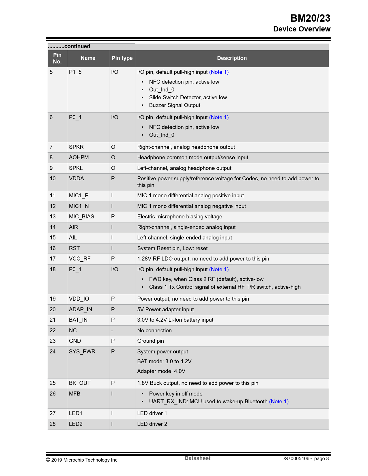

BM20/23. Device Overview. ...continued. Pin. Name. Pin type. Description. No. Datasheet
BM20/23 Device Overview ...continued Pin Name Pin type Description No Datasheet
link to page 9 link to page 9 link to page 9 link to page 9
BM20/23 Device Overview ...continued Pin Name Pin type Description No.
5 P1_5 I/O I/O pin, default pull-high input (Note 1) • NFC detection pin, active low • Out_Ind_0 • Slide Switch Detector, active low • Buzzer Signal Output 6 P0_4 I/O I/O pin, default pull-high input (Note 1) • NFC detection pin, active low • Out_Ind_0 7 SPKR O Right-channel, analog headphone output 8 AOHPM O Headphone common mode output/sense input 9 SPKL O Left-channel, analog headphone output 10 VDDA P Positive power supply/reference voltage for Codec, no need to add power to this pin 11 MIC1_P I MIC 1 mono differential analog positive input 12 MIC1_N I MIC 1 mono differential analog negative input 13 MIC_BIAS P Electric microphone biasing voltage 14 AIR I Right-channel, single-ended analog input 15 AIL I Left-channel, single-ended analog input 16 RST I System Reset pin, Low: reset 17 VCC_RF P 1.28V RF LDO output, no need to add power to this pin 18 P0_1 I/O I/O pin, default pull-high input (Note 1) • FWD key, when Class 2 RF (default), active-low • Class 1 Tx Control signal of external RF T/R switch, active-high 19 VDD_IO P Power output, no need to add power to this pin 20 ADAP_IN P 5V Power adapter input 21 BAT_IN P 3.0V to 4.2V Li-Ion battery input 22 NC - No connection 23 GND P Ground pin 24 SYS_PWR P System power output BAT mode: 3.0 to 4.2V Adapter mode: 4.0V 25 BK_OUT P 1.8V Buck output, no need to add power to this pin 26 MFB I • Power key in off mode • UART_RX_IND: MCU used to wake-up Bluetooth (Note 1) 27 LED1 I LED driver 1 28 LED2 I LED driver 2 © 2019 Microchip Technology Inc.
