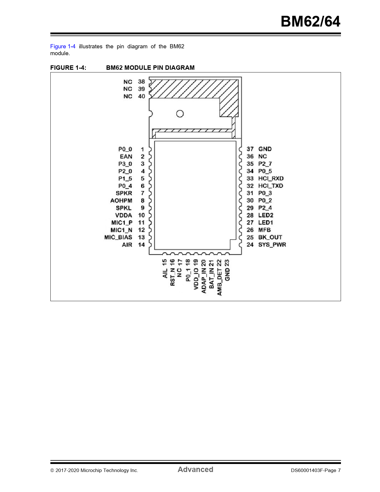

Figure 1-4 illustrates the pin diagram of the BM62 module.
FIGURE 1-4: BM62 MODULE PIN DIAGRAM
