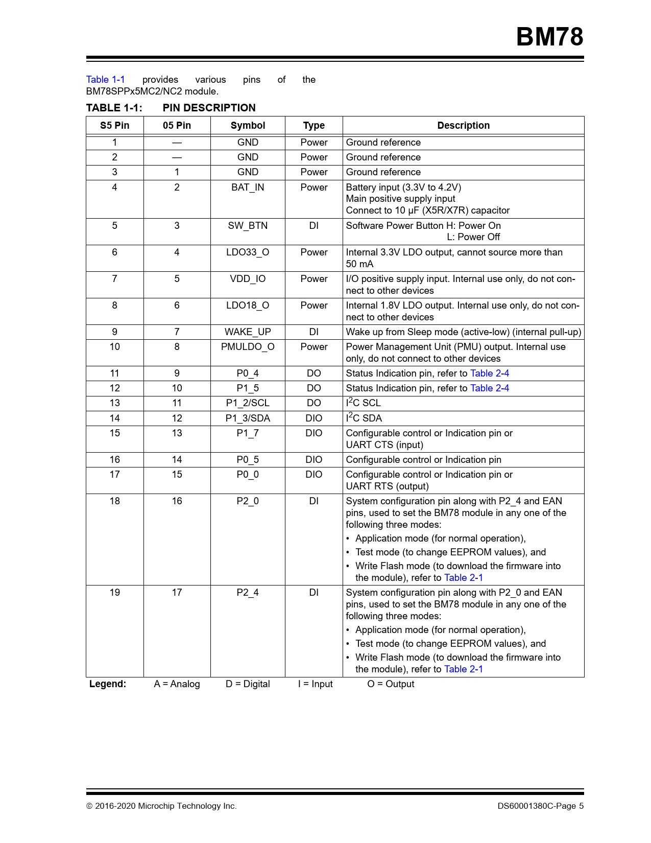

Table 1-1 provides various pins of the BM78SPPx5MC2/NC2 module.
TABLE 1-1: PIN DESCRIPTION S5 Pin 05 Pin Symbol Type Description
1 — GND Power Ground reference 2 — GND Power Ground reference 3 1 GND Power Ground reference 4 2 BAT_IN Power Battery input (3.3V to 4.2V) Main positive supply input Connect to 10 μF (X5R/X7R) capacitor 5 3 SW_BTN DI Software Power Button H: Power On  L: Power Off 6 4 LDO33_O Power Internal 3.3V LDO output, cannot source more than  50 mA 7 5 VDD_IO Power I/O positive supply input. Internal use only, do not con- nect to other devices 8 6 LDO18_O Power Internal 1.8V LDO output. Internal use only, do not con- nect to other devices 9 7 WAKE_UP DI Wake up from Sleep mode (active-low) (internal pull-up) 10 8 PMULDO_O Power Power Management Unit (PMU) output. Internal use only, do not connect to other devices 11 9 P0_4 DO Status Indication pin, refer to Table 2-4 12 10 P1_5 DO Status Indication pin, refer to Table 2-4 13 11 P1_2/SCL DO I2C SCL 14 12 P1_3/SDA DIO I2C SDA 15 13 P1_7 DIO Configurable control or Indication pin or UART CTS (input) 16 14 P0_5 DIO Configurable control or Indication pin 17 15 P0_0 DIO Configurable control or Indication pin or UART RTS (output) 18 16 P2_0 DI System configuration pin along with P2_4 and EAN pins, used to set the BM78 module in any one of the following three modes: • Application mode (for normal operation), • Test mode (to change EEPROM values), and • Write Flash mode (to download the firmware into the module), refer to Table 2-1 19 17 P2_4 DI System configuration pin along with P2_0 and EAN pins, used to set the BM78 module in any one of the following three modes: • Application mode (for normal operation), • Test mode (to change EEPROM values), and • Write Flash mode (to download the firmware into the module), refer to Table 2-1
