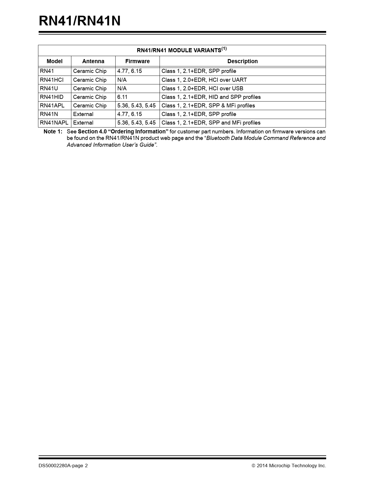

Pages / Page28 / 2 — RN41/RN41N. RN41/RN41 MODULE VARIANTS(1). Model. Antenna. Firmware. …
RN41/RN41N. RN41/RN41 MODULE VARIANTS(1). Model. Antenna. Firmware. Description. Note 1:. Section 4.0 “Ordering Information”
RN41/RN41N RN41/RN41 MODULE VARIANTS(1) Model Antenna Firmware Description Note 1: Section 4.0 “Ordering Information”
RN41 Ceramic Chip 4.77, 6.15 Class 1, 2.1+EDR, SPP profile RN41HCI Ceramic Chip N/A Class 1, 2.0+EDR, HCI over UART RN41U Ceramic Chip N/A Class 1, 2.0+EDR, HCI over USB RN41HID Ceramic Chip 6.11 Class 1, 2.1+EDR, HID and SPP profiles RN41APL Ceramic Chip 5.36, 5.43, 5.45 Class 1, 2.1+EDR, SPP & MFi profiles RN41N External 4.77, 6.15 Class 1, 2.1+EDR, SPP profile RN41NAPL External 5.36, 5.43, 5.45 Class 1, 2.1+EDR, SPP and MFi profiles
