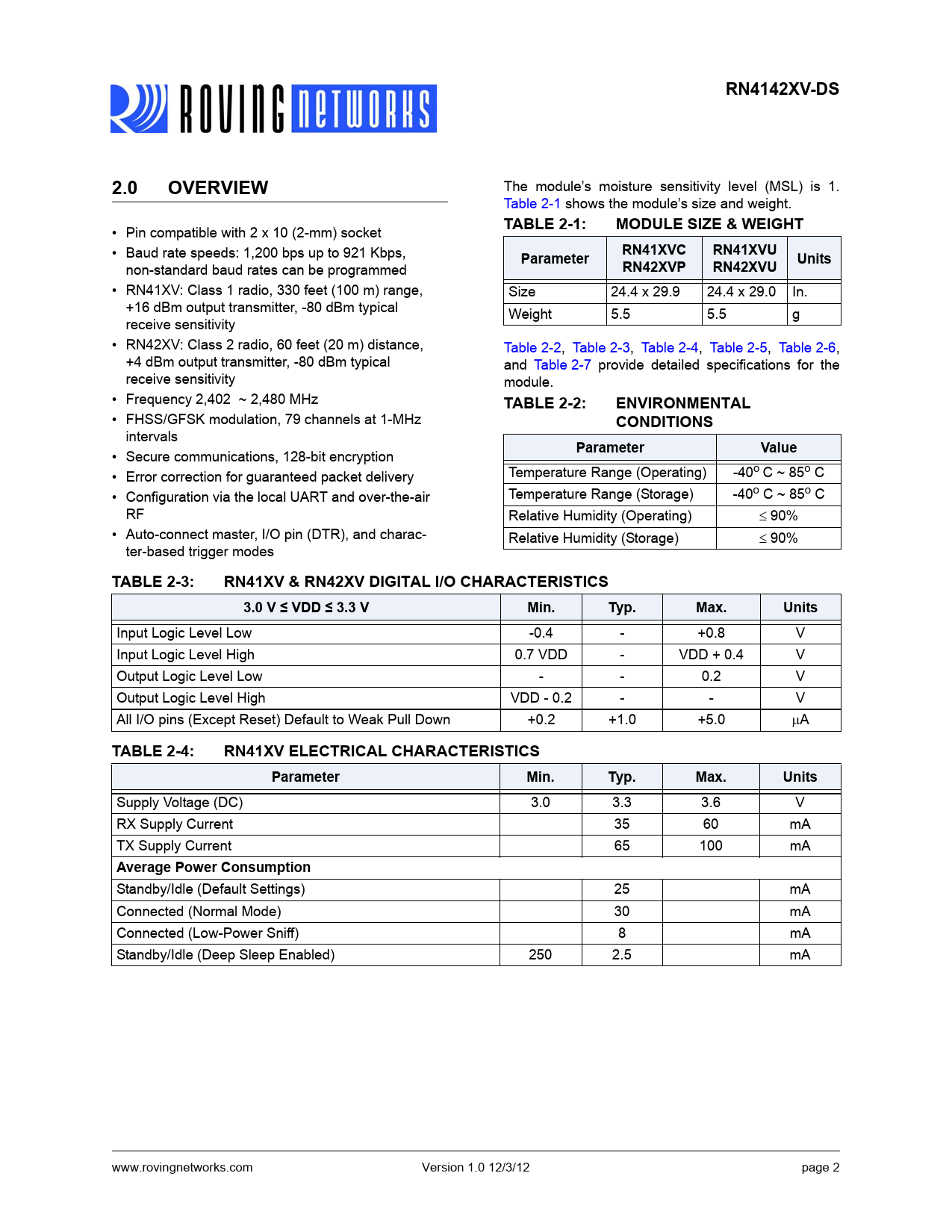

RN4142XV-DS 2.0 OVERVIEW
The module’s moisture sensitivity level (MSL) is 1. Table 2-1 shows the module’s size and weight.
TABLE 2-1: MODULE SIZE & WEIGHT
• Pin compatible with 2 x 10 (2-mm) socket • Baud rate speeds: 1,200 bps up to 921 Kbps,
RN41XVC RN41XVU Parameter Units
non-standard baud rates can be programmed
RN42XVP RN42XVU
• RN41XV: Class 1 radio, 330 feet (100 m) range, Size 24.4 x 29.9 24.4 x 29.0 In. +16 dBm output transmitter, -80 dBm typical Weight 5.5 5.5 g receive sensitivity • RN42XV: Class 2 radio, 60 feet (20 m) distance, Table 2-2, Table 2-3, Table 2-4, Table 2-5, Table 2-6, +4 dBm output transmitter, -80 dBm typical and Table 2-7 provide detailed specifications for the receive sensitivity module. • Frequency 2,402 ~ 2,480 MHz
TABLE 2-2: ENVIRONMENTAL
• FHSS/GFSK modulation, 79 channels at 1-MHz
CONDITIONS
intervals
Parameter Value
• Secure communications, 128-bit encryption • Error correction for guaranteed packet delivery Temperature Range (Operating) -40o C ~ 85o C • Configuration via the local UART and over-the-air Temperature Range (Storage) -40o C ~ 85o C RF Relative Humidity (Operating) ≤ 90% • Auto-connect master, I/O pin (DTR), and charac- Relative Humidity (Storage) ≤ 90% ter-based trigger modes
TABLE 2-3: RN41XV & RN42XV DIGITAL I/O CHARACTERISTICS 3.0 V ≤ VDD ≤ 3.3 V Min. Typ. Max. Units
Input Logic Level Low -0.4 - +0.8 V Input Logic Level High 0.7 VDD - VDD + 0.4 V Output Logic Level Low - - 0.2 V Output Logic Level High VDD - 0.2 - - V All I/O pins (Except Reset) Default to Weak Pull Down +0.2 +1.0 +5.0 μA
TABLE 2-4: RN41XV ELECTRICAL CHARACTERISTICS Parameter Min. Typ. Max. Units
Supply Voltage (DC) 3.0 3.3 3.6 V RX Supply Current 35 60 mA TX Supply Current 65 100 mA
Average Power Consumption
Standby/Idle (Default Settings) 25 mA Connected (Normal Mode) 30 mA Connected (Low-Power Sniff) 8 mA Standby/Idle (Deep Sleep Enabled) 250 2.5 mA www.rovingnetworks.com Version 1.0 12/3/12 page 2 Document Outline Features: Applications: 1.0 Description 2.0 Overview FIGURE 2-1: RN41XV & RN42XV Dimensions 3.0 Typical Application Schematic FIGURE 3-1: Application Schematic, Note 1 4.0 Design Concerns 4.1 Powering the Module 4.2 Reset Circuit 4.3 Factory Reset Using GPIO4 4.4 Connection Status 5.0 Compliance Information 6.0 Ordering Information
