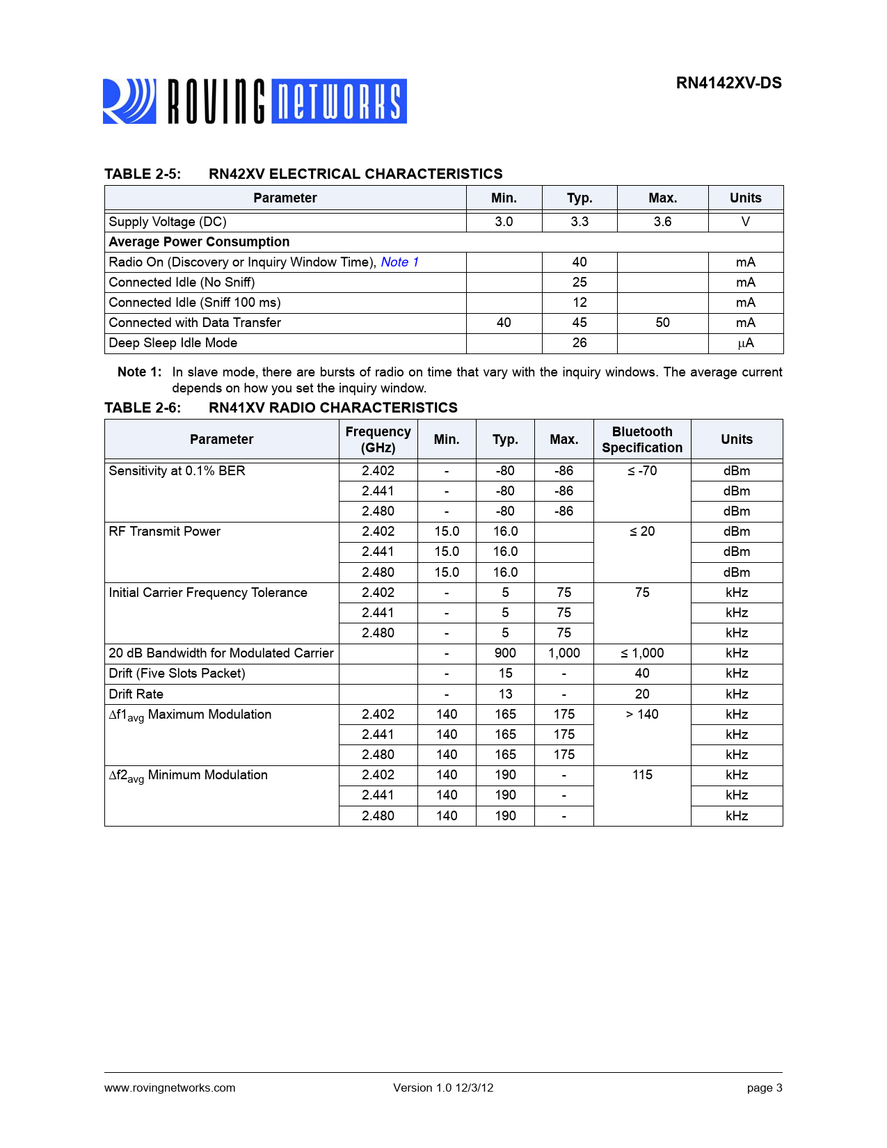

RN4142XV-DS TABLE 2-5: RN42XV ELECTRICAL CHARACTERISTICS Parameter Min. Typ. Max. Units
Supply Voltage (DC) 3.0 3.3 3.6 V
Average Power Consumption
Radio On (Discovery or Inquiry Window Time), Note 1 40 mA Connected Idle (No Sniff) 25 mA Connected Idle (Sniff 100 ms) 12 mA Connected with Data Transfer 40 45 50 mA Deep Sleep Idle Mode 26 μA
Note 1:
In slave mode, there are bursts of radio on time that vary with the inquiry windows. The average current depends on how you set the inquiry window.
TABLE 2-6: RN41XV RADIO CHARACTERISTICS Frequency Bluetooth Parameter Min. Typ. Max. Units (GHz) Specification
Sensitivity at 0.1% BER 2.402 - -80 -86 ≤ -70 dBm 2.441 - -80 -86 dBm 2.480 - -80 -86 dBm RF Transmit Power 2.402 15.0 16.0 ≤ 20 dBm 2.441 15.0 16.0 dBm 2.480 15.0 16.0 dBm Initial Carrier Frequency Tolerance 2.402 - 5 75 75 kHz 2.441 - 5 75 kHz 2.480 - 5 75 kHz 20 dB Bandwidth for Modulated Carrier - 900 1,000 ≤ 1,000 kHz Drift (Five Slots Packet) - 15 - 40 kHz Drift Rate - 13 - 20 kHz ∆f1avg Maximum Modulation 2.402 140 165 175 > 140 kHz 2.441 140 165 175 kHz 2.480 140 165 175 kHz ∆f2avg Minimum Modulation 2.402 140 190 - 115 kHz 2.441 140 190 - kHz 2.480 140 190 - kHz www.rovingnetworks.com Version 1.0 12/3/12 page 3 Document Outline Features: Applications: 1.0 Description 2.0 Overview FIGURE 2-1: RN41XV & RN42XV Dimensions 3.0 Typical Application Schematic FIGURE 3-1: Application Schematic, Note 1 4.0 Design Concerns 4.1 Powering the Module 4.2 Reset Circuit 4.3 Factory Reset Using GPIO4 4.4 Connection Status 5.0 Compliance Information 6.0 Ordering Information
