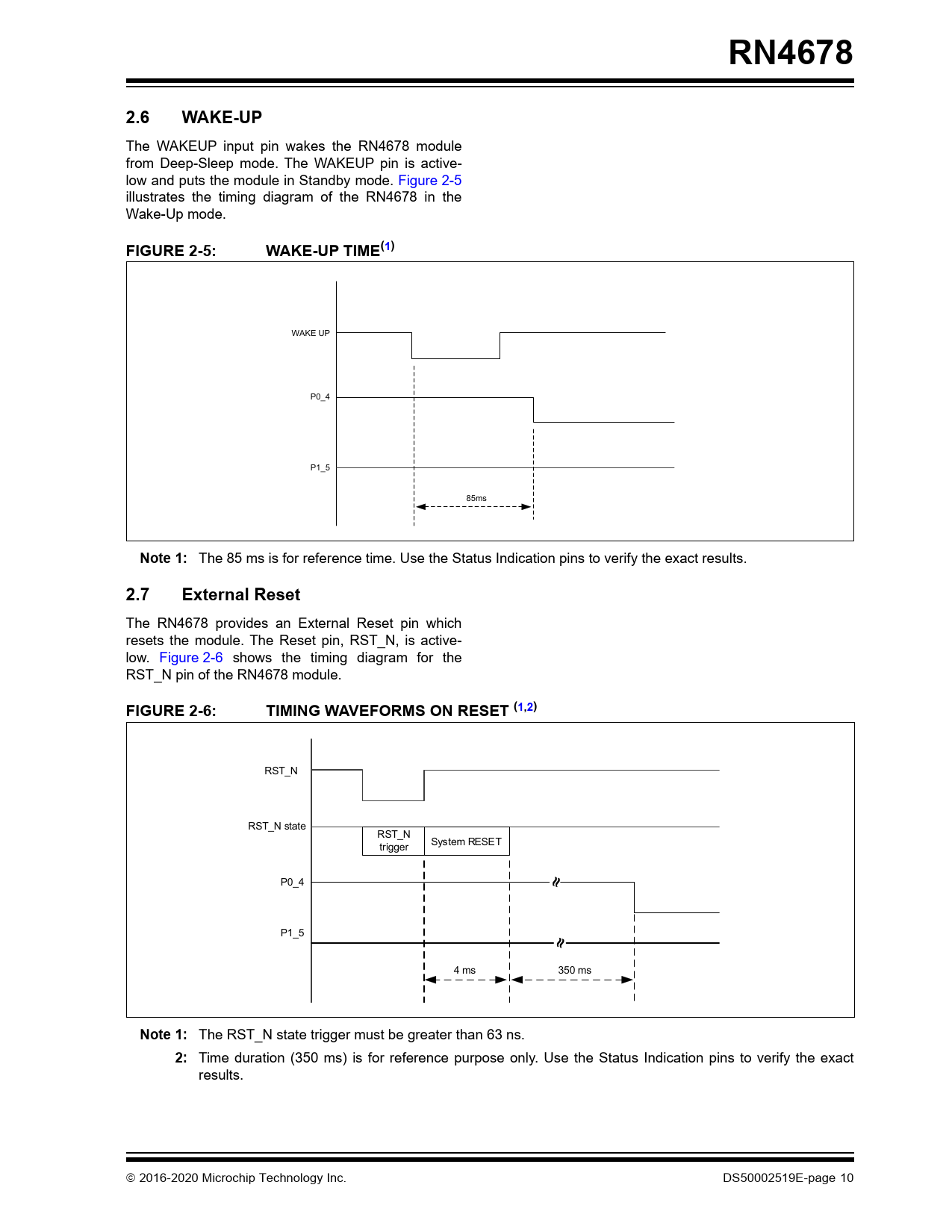

RN4678 2.6 WAKE-UP
The WAKEUP input pin wakes the RN4678 module from Deep-Sleep mode. The WAKEUP pin is active- low and puts the module in Standby mode. Figure 2-5 illustrates the timing diagram of the RN4678 in the Wake-Up mode.
FIGURE 2-5: WAKE-UP TIME(1)
WAKE UP P0_4 P1_5 85ms
Note 1:
The 85 ms is for reference time. Use the Status Indication pins to verify the exact results.
2.7 External Reset
The RN4678 provides an External Reset pin which resets the module. The Reset pin, RST_N, is active- low. Figure 2-6 shows the timing diagram for the RST_N pin of the RN4678 module.
FIGURE 2-6: TIMING WAVEFORMS ON RESET (1,2 )
RST_N RST_N state RST_N System RESET trigger P0_4 P1_5 4 ms 350 ms
Note 1:
The RST_N state trigger must be greater than 63 ns.
2:
Time duration (350 ms) is for reference purpose only. Use the Status Indication pins to verify the exact results.  2016-2020 Microchip Technology Inc. DS50002519E-page 10 Document Outline RN4678 Features RF/Analog Data Throughput Operating Conditions MAC/Baseband/Higher Layer Features Applications Description Table of Contents Most Current Data Sheet Errata Customer Notification System 1.0 Device Overview FIGURE 1-1: RN4678 Internal Block Diagram TABLE 1-1: PIN Description FIGURE 1-2: RN4678 PIN DIAGRAM 2.0 Application Information 2.1 Module Configuration 2.2 Flow Control 2.3 Control and Indication I/O Pins 2.4 Power Tree FIGURE 2-1: Power Tree Diagram 2.5 Software Button (SW_BTN) FIGURE 2-2: SW_BTN TIME (HIGH) AT APP MODE(1,2) FIGURE 2-3: SW_BTN TIME (LOW) AT ACCESS STATES(1) FIGURE 2-4: SW_BTN TIME (LOW) AT LINK STATES(1,2) 2.6 WAKE-UP FIGURE 2-5: WAKE-UP TIME(1) 2.7 External Reset FIGURE 2-6: TIMING WAVEFORMS ON RESET (1,2) 2.8 LED Driver FIGURE 2-7: LED Driver 2.9 Host MCU Interface over UART FIGURE 2-8: Power and MCU Interface Example for Rn4678 2.10 Reference Circuit FIGURE 2-9: RN4678 Reference Circuit 3.0 Electrical Characteristics Absolute Maximum Ratings TABLE 3-1: Recommended Operating Conditions TABLE 3-2: 3.3V LDO Electrical Parameters (1,2) TABLE 3-3: PMU LDO(1,2) TABLE 3-4: SAR-ADC AND Battery Voltage Detector TABLE 3-5: Intensity Controllable LED Driver TABLE 3-6: Power Consumption-Classic(1) TABLE 3-7: Power Consumption-Low Energy(1,2) 4.0 Radio Characteristics TABLE 4-1: Transmitter Performance (1,2) TABLE 4-2: Receiver Performance(1) 5.0 Physical Dimensions FIGURE 5-1: RN4678 Module Dimensions FIGURE 5-2: RN4678 Recommended PCB Footprint FIGURE 5-3: RN4678 Host PCB Mounting Suggestion 6.0 Reflow profile FIGURE 6-1: Reflow Profile 7.0 Module Placement FIGURE 7-1: Module Placement Examples TABLE 7-1: Recommended Antenna FIGURE 7-2: Keep Out Area Recommended for Antenna 7.1 RN4678 Ceramic Chip Antenna FIGURE 7-3: RN4678 Antenna Radiation Pattern 8.0 Ordering Information TABLE 8-1: Ordering Information 9.0 Regulatory Approval 9.1 United States 9.2 Canada 9.3 Europe TABLE 9-1: EUROPEAN COMPLIANCE TESTING 9.4 Japan 9.5 Korea 9.6 Taiwan 9.7 China 9.8 Other Regulatory Information Appendix A: Revision History The Microchip WebSite Product Identification System Trademarks Worldwide Sales
