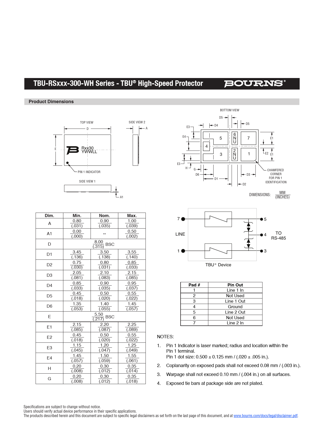

TBU-RSxxx-300-WH Series - TBU® High-Speed Protector. Product Dimensions. Dim. Min. Nom. Max. Pad #. Pin Out
TBU-RSxxx-300-WH Series - TBU® High-Speed Protector Product Dimensions Dim Min Nom Max Pad # Pin Out
BOTTOM VIEW D5 TOP VIEW SIDE VIEW 2 D5 D4 D A E3 6 E4 5 N 7 E1 U 4 E Rxx30 YWWLL 2 E2 3 N 1 E1 U E3 H G PIN 1 INDICATOR CHAMFERED D6 D3 CORNER D1 FOR PIN 1 SIDE VIEW 1 IDENTIFICATION D2 DIMENSIONS: MM A1 (INCHES) 0.90 (.035)
Dim. Min. Nom. Max.
3.60 0.90 1.00 7 2.20 (.142) 1.40 5 A 0.80 (.031) (.035) (.039) 2.30 (.087) (.055) (.091) 1.30 0.40 A1 0.00 LINE TO (.051)4 (.016) (.000) -- 0.50 (.002) 0.40 RS-485 (.016) D 8.00 BSC (.315) ...F 1 3 D1 3.45 3.50 3.55 (.136) (.138) (.140) D2 0.75 0.80 0.85 TBU® Device 1.60 0.40 (.030) (.031) (.033) 2.30 0.40 (.063) (.016) 2.10 2.15 1.00 D3 2.05 (.016) 1.30 (.091) (.081) (.083) (.085) (.039) (.051) 0.40 1.40 D4 0.85 0.90 0.95
Pad #
(.016)
Pin Out
(.055) (.033) (.035) (.037) 1 Line 1 In D5 0.45 0.50 0.55 2 Not Used (.018) (.020) (.022) 3 Line 1 Out D6 1.35 1.40 1.45 4 Ground (.053) (.055) (.057) 5 Line 2 Out E 5.50 BSC 6 Not Used (.217) ...F 7 Line 2 In E1 2.15 2.20 2.25 (.085) (.087) (.089) E2 0.45 0.50 0.55 NOTES: (.018) (.020) (.022) 1.20 1.25 1. Pin 1 Indicator is laser marked; radius and location within the E3 1.15 (.045) (.047) (.049) Pin 1 terminal. E4 1.45 1.50 1.55 Pin 1 dot size: 0.500 ± 0.125 mm / (.020 ± .005 in.). (.057) (.059) (.061) 0.30 0.35 2. Coplanarity on exposed pads shall not exceed 0.08 mm / (.003 in.). H 0.20 (.008) (.012) (.014) 3. Warpage shall not exceed 0.10 mm / (.004 in.) on all surfaces. G 0.20 0.30 0.35 (.008) (.012) (.018) 4. Exposed tie bars at package side are not plated. Specifications are subject to change without notice. Users should verify actual device performance in their specific applications. The products described herein and this document are subject to specific legal disclaimers as set forth on the last page of this document, and at www.bourns.com/docs/legal/disclaimer.pdf.
