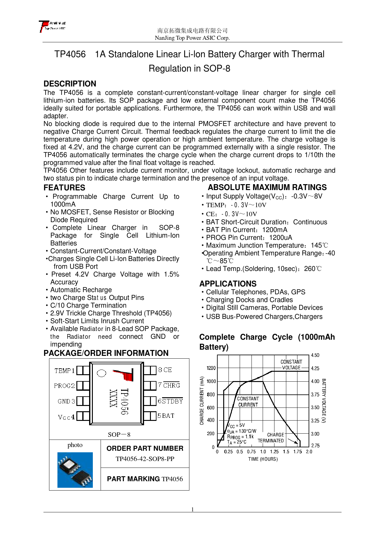

南京拓微集成电路有限公司 NanJing Top Power ASIC Corp. TP4056 1A Standalone Linear Li-lon Battery Charger with Thermal Regulation in SOP-8
DESCRIPTION
The TP4056 is a complete constant-current/constant-voltage linear charger for single cell lithium-ion batteries. Its SOP package and low external component count make the TP4056 ideally suited for portable applications. Furthermore, the TP4056 can work within USB and wall adapter. No blocking diode is required due to the internal PMOSFET architecture and have prevent to negative Charge Current Circuit. Thermal feedback regulates the charge current to limit the die temperature during high power operation or high ambient temperature. The charge voltage is fixed at 4.2V, and the charge current can be programmed externally with a single resistor. The TP4056 automatically terminates the charge cycle when the charge current drops to 1/10th the programmed value after the final float voltage is reached. TP4056 Other features include current monitor, under voltage lockout, automatic recharge and two status pin to indicate charge termination and the presence of an input voltage.
FEATURES ABSOLUTE MAXIMUM RATINGS
· Programmable Charge Current Up to ·Input Supply Voltage(VCC):-0.3V~8V 1000mA ·TEMP:-0.3V~10V ·No MOSFET, Sense Resistor or Blocking ·CE:-0.3V~10V Diode Required ·BAT Short-Circuit Duration:Continuous · Complete Linear Charger in SOP-8 ·BAT Pin Current:1200mA Package for Single Cell Lithium-Ion ·PROG Pin Current:1200uA Batteries ·Maximum Junction Temperature:145℃ ·Constant-Current/Constant-Voltage ·Operating Ambient Temperature Range:-40 ·Charges Single Cell Li-Ion Batteries Directly ℃~85℃ from USB Port ·Lead Temp.(Soldering, 10sec):260℃ · Preset 4.2V Charge Voltage with 1.5%
Accuracy
APPLICATIONS
·Automatic Recharge ·Cellular Telephones, PDAs, GPS ·two Charge Status Output Pins ·Charging Docks and Cradles ·C/10 Charge Termination ·Digital Still Cameras, Portable Devices ·2.9V Trickle Charge Threshold (TP4056) ·USB Bus-Powered Chargers,Chargers ·Soft-Start Limits Inrush Current ·Available Radiator in 8-Lead SOP Package,
the Radiator need connect GND or
Complete Charge Cycle (1000mAh
impending
Battery) PACKAGE/ORDER INFORMATION
SOP-8 photo
ORDER PART NUMBER
TP4056-42-SOP8-PP
PART MARKING
TP4056
