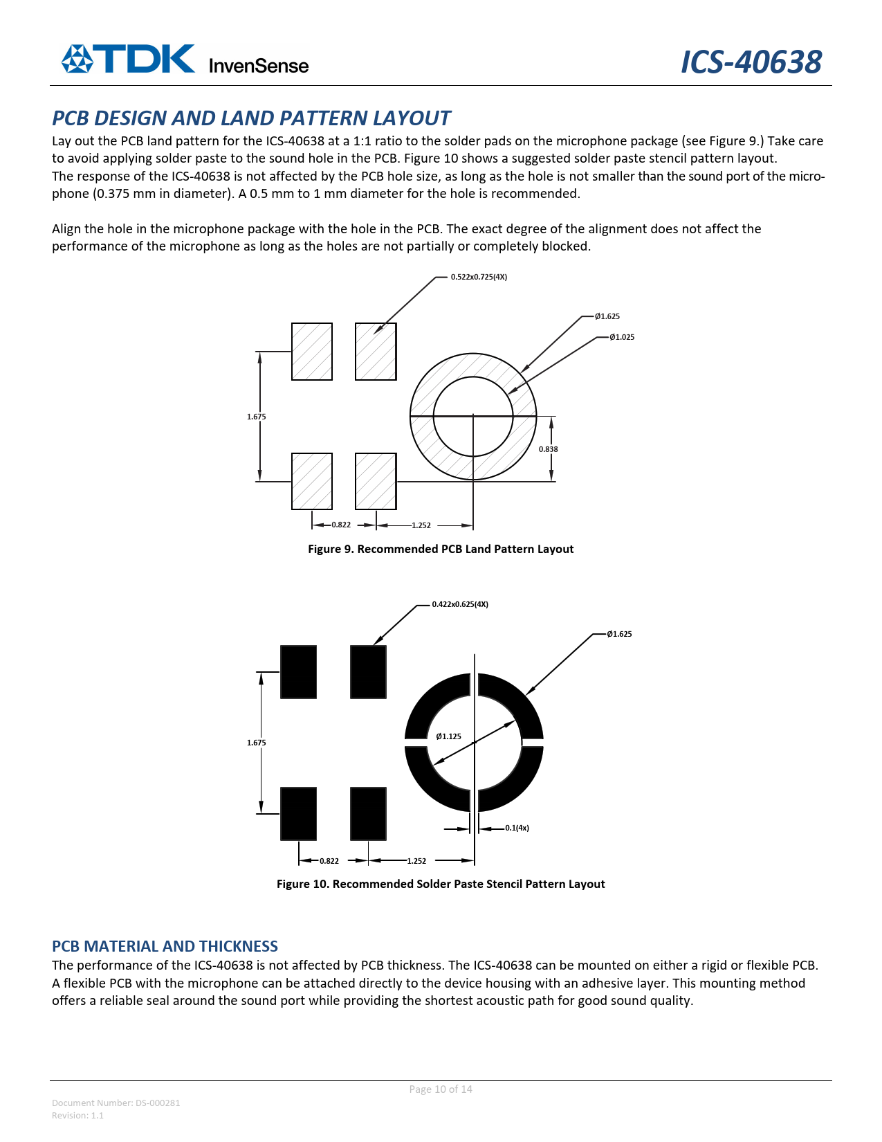

  ICS‐40638. PCB DESIGN AND LAND PATTERN LAYOUT . 0.522x0.725(4X). Ø1.625. Ø1.025. 1.675. 0.838. 0.822. 1.252
  ICS‐40638 PCB DESIGN AND LAND PATTERN LAYOUT  0.522x0.725(4X) Ø1.625 Ø1.025 1.675 0.838 0.822 1.252
    ICS‐40638
Lay out the PCB land pattern for the ICS‐40638 at a 1:1 ratio to the solder pads on the microphone package (see Figure 9.) Take care  to avoid applying solder paste to the sound hole in the PCB. Figure 10 shows a suggested solder paste stencil pattern layout.  The response of the ICS‐40638 is not affected by the PCB hole size, as long as the hole is not smaller than the sound port of the micro‐ phone (0.375 mm in diameter). A 0.5 mm to 1 mm diameter for the hole is recommended.    Align the hole in the microphone package with the hole in the PCB. The exact degree of the alignment does not affect the  performance of the microphone as long as the holes are not partially or completely blocked.
Figure 9. Recommended PCB Land Pattern Layout
0.422x0.625(4X) Ø1.625 Ø1.125 1.675 0.1(4x) 0.822 1.252
Figure 10. Recommended Solder Paste Stencil Pattern Layout
PCB MATERIAL AND THICKNESS
The performance of the ICS‐40638 is not affected by PCB thickness. The ICS‐40638 can be mounted on either a rigid or flexible PCB.  A flexible PCB with the microphone can be attached directly to the device housing with an adhesive layer. This mounting method  offers a reliable seal around the sound port while providing the shortest acoustic path for good sound quality.  Page 10 of 14  Document Number: DS‐000281  Revision: 1.1
