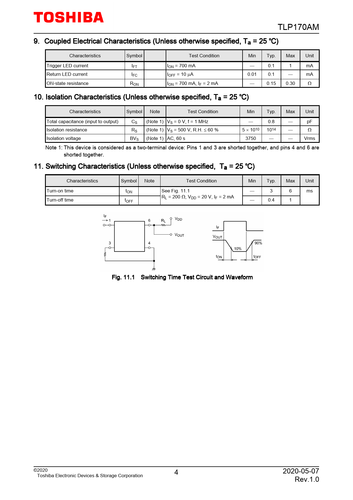

TLP170AM. 9. Coupled. Electrical. Characteristics. (Unless. otherwise. specified,. Ta. =. 25. ). Characteristics. Symbol. Test. Condition. Min. Typ. Max
TLP170AM 9 Coupled Electrical Characteristics (Unless otherwise specified, Ta = 25 ) Characteristics Symbol Test Condition Min Typ Max
TLP170AM 9. Coupled Electrical Characteristics (Unless otherwise specified, Ta = 25 ) Characteristics Symbol Test Condition Min Typ. Max Unit Trigger LED current IFT ION = 700 mA  0.1 1 mA Return LED current IFC IOFF = 10 µA 0.01 0.1  mA ON-state resistance RON ION = 700 mA, IF = 2 mA  0.15 0.30 Ω 10. Isolation Characteristics (Unless otherwise specified, Ta = 25 ) Characteristics Symbol Note Test Condition Min Typ. Max Unit Total capacitance (input to output) CS (Note 1) VS = 0 V, f = 1 MHz  0.8  pF Isolation resistance RS (Note 1) VS = 500 V, R.H. ≤ 60 % 5 × 1010 1014  Ω Isolation voltage BVS (Note 1) AC, 60 s 3750   Vrms Note 1: This device is considered as a two-terminal device: Pins 1 and 3 are shorted together, and pins 4 and 6 are shorted together. 11. Switching Characteristics (Unless otherwise specified, Ta = 25 ) Characteristics Symbol Note Test Condition Min Typ. Max Unit Turn-on time tON See Fig. 11.1  3 6 ms RL = 200 Ω, VDD = 20 V, IF = 2 mA Turn-off time tOFF  0.4 1 Fig. 11.1 Switching Time Test Circuit and Waveform ©2020 4 2020-05-07 Toshiba Electronic Devices & Storage Corporation Rev.1.0
