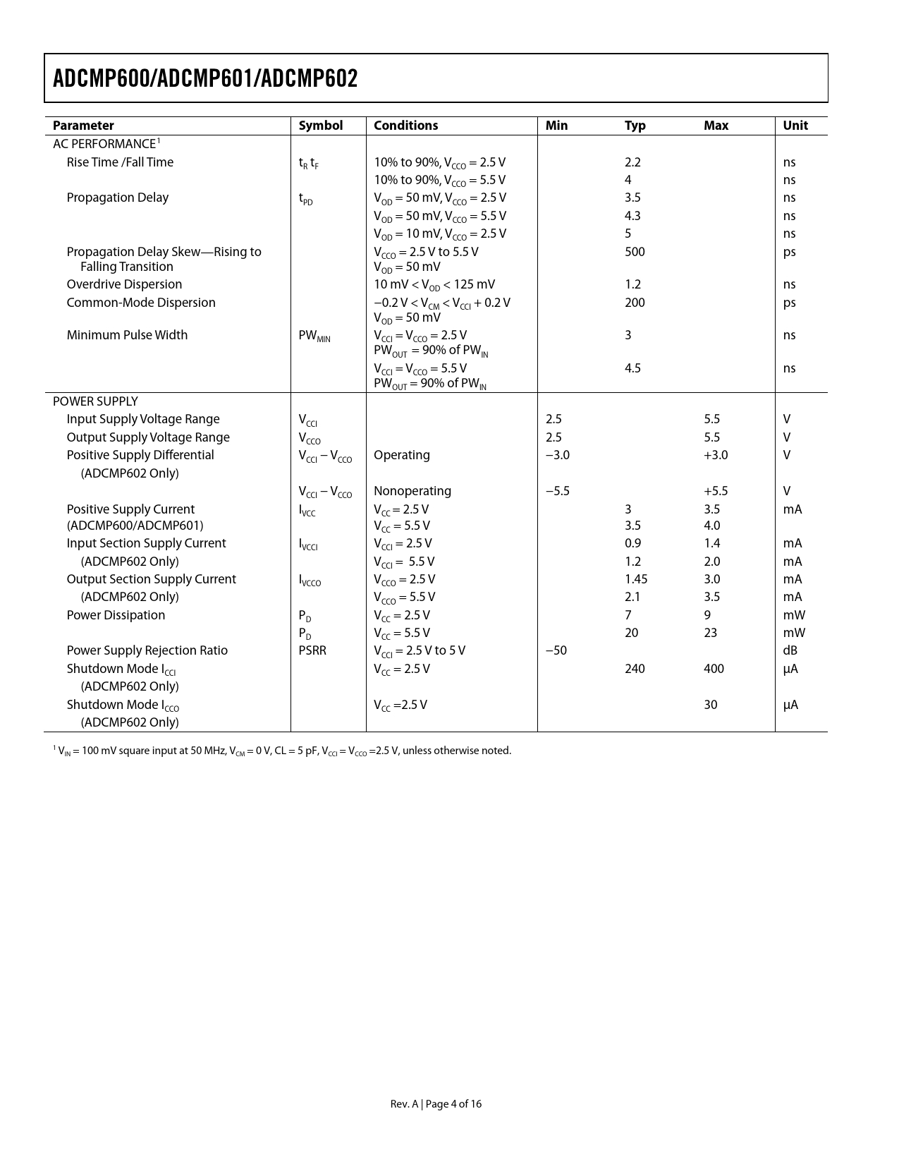

ADCMP600/ADCMP601/ADCMP602. Parameter. Symbol. Conditions. Min. Typ. Max. Unit
ADCMP600/ADCMP601/ADCMP602 Parameter Symbol Conditions Min Typ Max Unit
link to page 4
AC PERFORMANCE1 Rise Time /Fall Time t t 10% to 90%, V = 2.5 V 2.2 ns R F CCO 10% to 90%, V = 5.5 V 4 ns CCO Propagation Delay t V = 50 mV, V = 2.5 V 3.5 ns PD OD CCO V = 50 mV, V = 5.5 V 4.3 ns OD CCO V = 10 mV, V = 2.5 V 5 ns OD CCO Propagation Delay Skew—Rising to V = 2.5 V to 5.5 V 500 ps CCO Falling Transition V = 50 mV OD Overdrive Dispersion 10 mV < V < 125 mV 1.2 ns OD Common-Mode Dispersion −0.2 V < V < V + 0.2 V 200 ps CM CCI V = 50 mV OD Minimum Pulse Width PW V = V = 2.5 V 3 ns MIN CCI CCO PW = 90% of PW OUT IN V = V = 5.5 V 4.5 ns CCI CCO PW = 90% of PW OUT IN POWER SUPPLY Input Supply Voltage Range V 2.5 5.5 V CCI Output Supply Voltage Range V 2.5 5.5 V CCO Positive Supply Differential V − V Operating −3.0 +3.0 V CCI CCO (ADCMP602 Only) V − V Nonoperating −5.5 +5.5 V CCI CCO Positive Supply Current I V = 2.5 V 3 3.5 mA VCC CC (ADCMP600/ADCMP601) V = 5.5 V 3.5 4.0 CC Input Section Supply Current I V = 2.5 V 0.9 1.4 mA VCCI CCI (ADCMP602 Only) V = 5.5 V 1.2 2.0 mA CCI Output Section Supply Current I V = 2.5 V 1.45 3.0 mA VCCO CCO (ADCMP602 Only) V = 5.5 V 2.1 3.5 mA CCO Power Dissipation P V = 2.5 V 7 9 mW D CC P V = 5.5 V 20 23 mW D CC Power Supply Rejection Ratio PSRR V = 2.5 V to 5 V −50 dB CCI Shutdown Mode I V = 2.5 V 240 400 µA CCI CC (ADCMP602 Only) Shutdown Mode I V =2.5 V 30 µA CCO CC (ADCMP602 Only) 1 VIN = 100 mV square input at 50 MHz, VCM = 0 V, CL = 5 pF, VCCI = VCCO =2.5 V, unless otherwise noted. Rev. A | Page 4 of 16 Document Outline Features Applications Functional Block Diagram General Description Revision History Specifications Electrical Characteristics Timing Information Absolute Maximum Ratings Thermal Resistance ESD Caution Pin Configuration and Function Descriptions Typical Performance Characteristics Application Information Power/Ground Layout and Bypassing TTL-/CMOS-Compatible Output Stage Using/Disabling the Latch Feature Optimizing Performance Comparator Propagation Delay Dispersion Comparator Hysteresis Crossover Bias Point Minimum Input Slew Rate Requirement Typical Application Circuits Outline Dimensions Ordering Guide
