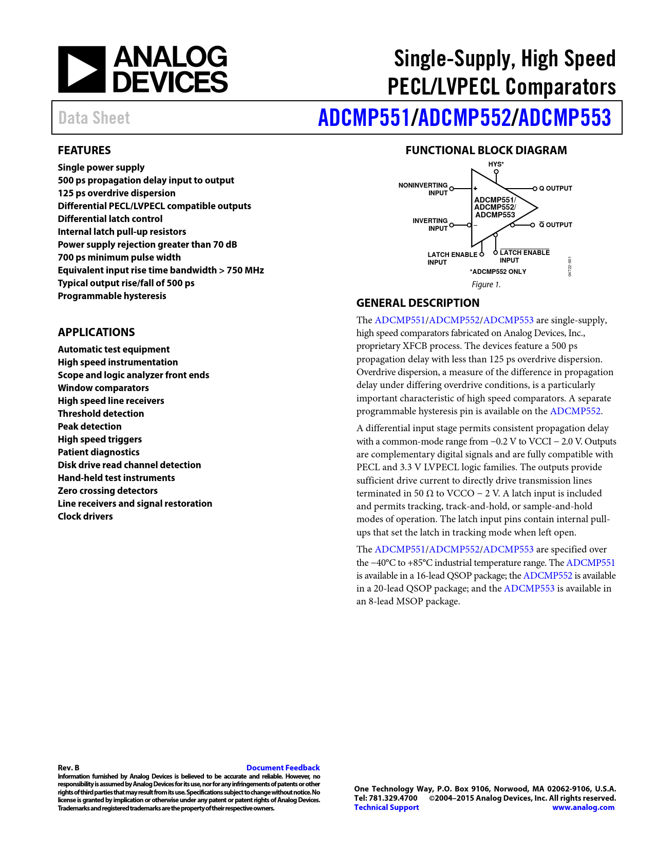

Single-Supply, High Speed. PECL/LVPECL Comparators. Data Sheet. ADCMP551/. ADCMP552/. ADCMP553. FEATURES. FUNCTIONAL BLOCK DIAGRAM
Single-Supply, High Speed PECL/LVPECL Comparators Data Sheet ADCMP551/ ADCMP552/ ADCMP553 FEATURES FUNCTIONAL BLOCK DIAGRAM Single power supply HYS* 500 ps propagation delay input to output NONINVERTING Q OUTPUT 125 ps overdrive dispersion INPUT ADCMP551/ Differential PECL/LVPECL compatible outputs ADCMP552/ Differential latch control ADCMP553 INVERTING Q OUTPUT Internal latch pull-up resistors INPUT Power supply rejection greater than 70 dB LATCH ENABLE 700 ps minimum pulse width LATCH ENABLE INPUT INPUT Equivalent input rise time bandwidth > 750 MHz *ADCMP552 ONLY
04722-001
Typical output rise/fall of 500 ps
Figure 1.
Programmable hysteresis GENERAL DESCRIPTION
The ADCMP551/ADCMP552/ADCMP553 are single-supply,
APPLICATIONS
high speed comparators fabricated on Analog Devices, Inc.,
Automatic test equipment
proprietary XFCB process. The devices feature a 500 ps
High speed instrumentation
propagation delay with less than 125 ps overdrive dispersion.
Scope and logic analyzer front ends
Overdrive dispersion, a measure of the difference in propagation
Window comparators
delay under differing overdrive conditions, is a particularly
High speed line receivers
important characteristic of high speed comparators. A separate
Threshold detection
programmable hysteresis pin is available on the ADCMP552.
Peak detection
A differential input stage permits consistent propagation delay
High speed triggers
with a common-mode range from −0.2 V to VCCI − 2.0 V. Outputs
Patient diagnostics
are complementary digital signals and are fully compatible with
Disk drive read channel detection
PECL and 3.3 V LVPECL logic families. The outputs provide
Hand-held test instruments
sufficient drive current to directly drive transmission lines
Zero crossing detectors
terminated in 50 Ω to VCCO − 2 V. A latch input is included
Line receivers and signal restoration
and permits tracking, track-and-hold, or sample-and-hold
Clock drivers
modes of operation. The latch input pins contain internal pull- ups that set the latch in tracking mode when left open. The ADCMP551/ADCMP552/ADCMP553 are specified over the −40°C to +85°C industrial temperature range. The ADCMP551 is available in a 16-lead QSOP package; the ADCMP552 is available in a 20-lead QSOP package; and the ADCMP553 is available in an 8-lead MSOP package.
