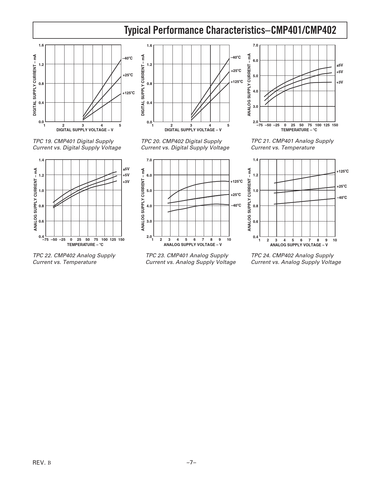

Pages / Page8 / 7 — Typical Performance Characteristics–CMP401/CMP402. 1.6. 7.0. –40. – 6.0. …

Typical Performance Characteristics–CMP401/CMP402. 1.6. 7.0. –40. – 6.0. 1.2. +25. +5V. 5.0. +125. 0.8. +3V. 4.0. 0.4. 3.0. DIGITAL SUPPLY CURRENT
Typical Performance Characteristics–CMP401/CMP402 1.6 7.0 –40 – 6.0 1.2 +25 +5V 5.0 +125 0.8 +3V 4.0 0.4 3.0 DIGITAL SUPPLY CURRENT
Typical Performance Characteristics–CMP401/CMP402 1.6 1.6 7.0 –40
C mA –40
C mA mA – 6.0 1.2 1.2 5V +25
C +5V +25
C 5.0 +125
C 0.8 0.8 +3V +125
C 4.0 0.4 0.4 3.0 DIGITAL SUPPLY CURRENT DIGITAL SUPPLY CURRENT ANALOG SUPPLY CURRENT 0.0 0.0 2.0 1 2 3 4 5 1 2 3 4 5 –75 –50 –25 0 25 50 75 100 125 150 DIGITAL SUPPLY VOLTAGE – V DIGITAL SUPPLY VOLTAGE – V TEMPERATURE –
C
TPC 19. CMP401 Digital Supply TPC 20. CMP402 Digital Supply TPC 21. CMP401 Analog Supply Current vs. Digital Supply Voltage Current vs. Digital Supply Voltage Current vs. Temperature
1.4 7.0 1.4 5V +125
C mA mA mA – 1.2 +5V 6.0 1.2 +3V +125
C +25
C 1.0 5.0 1.0 +25
C –40
C 0.8 4.0 –40
C 0.8 0.6 3.0 0.6 ANALOG SUPPLY CURRENT ANALOG SUPPLY CURRENT ANALOG SUPPLY CURRENT 0.4 2.0 0.4 –75 –50 –25 0 25 50 75 100 125 150 1 2 3 4 5 6 7 8 9 10 1 2 3 4 5 6 7 8 9 10 TEMPERATURE –
C ANALOG SUPPLY VOLTAGE – V ANALOG SUPPLY VOLTAGE – V
TPC 22. CMP402 Analog Supply TPC 23. CMP401 Analog Supply TPC 24. CMP402 Analog Supply Current vs. Temperature Current vs. Analog Supply Voltage Current vs. Analog Supply Voltage REV. B –7–
