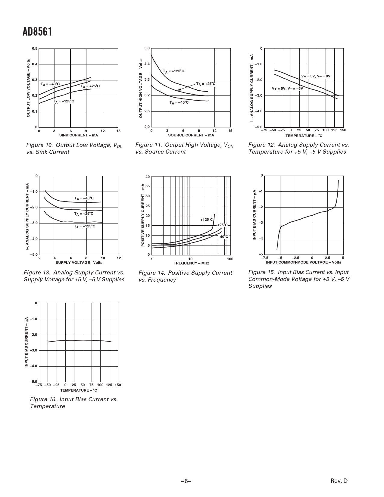

AD8561. 0.5. 5.0. 0.4. 4.4. –1.0. TA = +125. V+ = 5V, V– = 0V. 0.3. 3.8. –2.0. TA = –40. A = +25. V+ = 5V, V– = –5V. 0.2. 3.2. –3.0. 0.1. 2.6. –4.0
AD8561 0.5 5.0 0.4 4.4 –1.0 TA = +125 V+ = 5V, V– = 0V 0.3 3.8 –2.0 TA = –40 A = +25 V+ = 5V, V– = –5V 0.2 3.2 –3.0 0.1 2.6 –4.0
AD8561 0.5 5.0 0 0.4 4.4 –1.0 TA = +125

C 0.1 2.6 –4.0 OUTPUT LOW VOLTAGE – Volts OUTPUT HIGH VOLTAGE – Volts I–, ANALOG SUPPLY CURRENT – mA 0 2.0 –5.0 0 3 6 9 12 15 0 3 6 9 12 15 –75 –50 –25 0 25 50 75 100 125 150 SINK CURRENT – mA SOURCE CURRENT – mA TEMPERATURE –

Figure 10. Output Low Voltage, V Figure 11. Output High Voltage, V Figure 12. Analog Supply Current vs. OL OH vs. Sink Current vs. Source Current Temperature for +5 V, –5 V Supplies
0 40 0 35 –1.0 A –1

C –4.0 INPUT BIAS CURRENT – –4 POSITIVE SUPPLY CURRENT – mA 5 I–, ANALOG SUPPLY CURRENT – mA –5.0 0 –5 2 4 6 8 10 12 1 10 100 –7.5 –5 –2.5 0 2.5 5 SUPPLY VOLTAGE –Volts FREQUENCY – MHz INPUT COMMON-MODE VOLTAGE – Volts
Figure 13. Analog Supply Current vs. Figure 14. Positive Supply Current Figure 15. Input Bias Current vs. Input Supply Voltage for +5 V, –5 V Supplies vs. Frequency Common-Mode Voltage for +5 V, –5 V Supplies

–1.0 –2.0 –3.0 INPUT BIAS CURRENT – –4.0 –5.0–75 –50 –25 0 25 50 75 100 125 150 TEMPERATURE –

Figure 16. Input Bias Current vs. Temperature –6– Rev. D Document Outline Features Applications General Description Pin Configurations Specifications Electrical Specifications Absolute Maximum Ratings Typical Performance Characteristics Applications Optimizing High Speed Performance Replacing the LT1016 Increasing Output Swing Output Loading Considerations Setup and Hold Times for Latching the Output Input Stage and Bias Currents Using Hysteresis SPICE Model Outline Dimensions Ordering Guide Revision History
