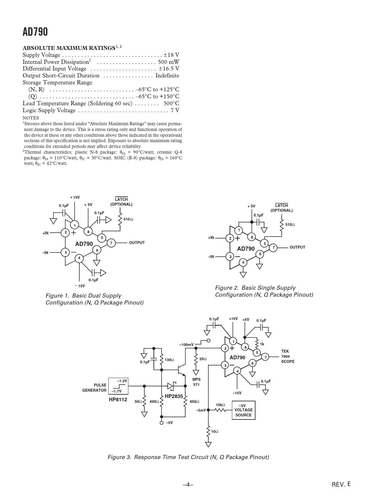

AD790. ABSOLUTE MAXIMUM RATINGS1, 2. + 15V. LATCH. 0.1µF. + 5V. (OPTIONAL). 510. +IN. OUTPUT. –IN. – 15V. +15V. +5V. –100mV. TEK. 7904. 130. SCOPE. –1.3V. MPS
AD790 ABSOLUTE MAXIMUM RATINGS1, 2 + 15V LATCH 0.1µF + 5V (OPTIONAL) 510 +IN OUTPUT –IN – 15V +15V +5V –100mV TEK 7904 130 SCOPE –1.3V MPS
Supply Voltage . ± 18 V Internal Power Dissipation2 . 500 mW Differential Input Voltage . ± 16.5 V Output Short-Circuit Duration . Indefinite Storage Temperature Range (N, R) . –65°C to +125°C (Q) . –65°C to +150°C Lead Temperature Range (Soldering 60 sec) . 300°C Logic Supply Voltage . 7 V NOTES 1Stresses above those listed under “Absolute Maximum Ratings” may cause perma- nent damage to the device. This is a stress rating only and functional operation of the device at these or any other conditions above those indicated in the operational sections of this specification is not implied. Exposure to absolute maximum rating conditions for extended periods may affect device reliability. 2Thermal characteristics: plastic N-8 package: θJA = 90°C/watt; ceramic Q-8 package: θJA = 110°C/watt, θJC = 30°C/watt. SOIC (R-8) package: θJA = 160°C watt; θJC = 42°C/watt.
+ 15V LATCH 0.1µF + 5V (OPTIONAL) + 5V LATCH (OPTIONAL) 0.1µF 0.1µF 510
1 510
1 +IN 2 8 5 +IN 2 8 AD790 7 OUTPUT 5 7 OUTPUT 6 AD790 –IN 3 6 4 –IN 3 4 0.1µF – 15V
Figure 2. Basic Single Supply Figure 1. Basic Dual Supply Configuration (N, Q Package Pinout) Configuration (N, Q Package Pinout)
0.1µF +15V +5V 0.1µF 1 –100mV 1k 2 8 5 TEK AD790 7 7904 130
25
0.1µF SCOPE 6 3 4 –1.3V MPS 0.1µF PULSE 571 GENERATOR –1.7V –15V HP2835 HP8112 50
400
650
10k
–5V –5mV VOLTAGE SOURCE –5V 10
Ω Figure 3. Response Time Test Circuit (N, Q Package Pinout) –4– REV. E
