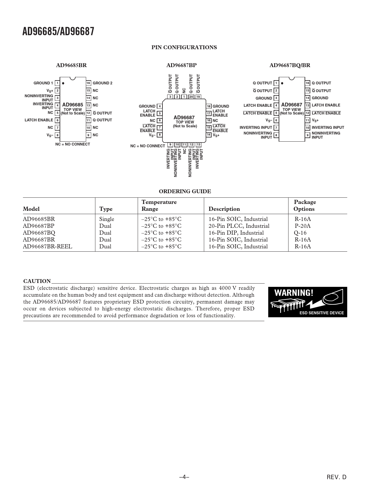

AD96685/AD96687. PIN CONFIGURATIONS. AD96685BR. AD96687BP. AD96687BQ/BR. GROUND 1. 16 GROUND 2. Q OUTPUT 1. 16 Q OUTPUT. OUTPUT. VS+ 2. 15 NC
AD96685/AD96687 PIN CONFIGURATIONS AD96685BR AD96687BP AD96687BQ/BR GROUND 1 1 16 GROUND 2 Q OUTPUT 1 16 Q OUTPUT OUTPUT OUTPUT VS+ 2 15 NC Q Q OUTPUT NC Q OUTPUT Q Q OUTPUT 2 15 Q OUTPUT NONINVERTING 3 2 1 20 19 3 14 NC GROUND 3 14 GROUND INPUT INVERTING 4 AD96685 13 NC GROUND 4 18 GROUND LATCH ENABLE 4 AD96687 13 LATCH ENABLE INPUT TOP VIEW LATCH LATCH TOP VIEW NC 5 (Not to Scale) 12 Q OUTPUT 5 17 LATCH ENABLE 5 (Not to Scale) 12 LATCH ENABLE ENABLE AD96687 ENABLE LATCH ENABLE 6 11 Q OUTPUT NC 6 16 V 6 11 V TOP VIEW NC S– S+ LATCH (Not to Scale) LATCH NC 7 10 NC 7 15 INVERTING INPUT 7 10 INVERTING INPUT ENABLE ENABLE V NONINVERTING NONINVERTING 8 9 NC 8 14 V S– S– VS+ 8 9 INPUT INPUT NC = NO CONNECT 9 10 11 12 13 NC = NO CONNECT NC TING TING TING TING INPUT INPUT INPUT INPUT INVER INVER NONINVER NONINVER ORDERING GUIDE Temperature Package Model Type Range Description Options
AD96685BR Single –25°C to +85°C 16-Pin SOIC, Industrial R-16A AD96687BP Dual –25°C to +85°C 20-Pin PLCC, Industrial P-20A AD96687BQ Dual –25°C to +85°C 16-Pin DIP, Industrial Q-16 AD96687BR Dual –25°C to +85°C 16-Pin SOIC, Industrial R-16A AD96687BR-REEL Dual –25°C to +85°C 16-Pin SOIC, Industrial R-16A
