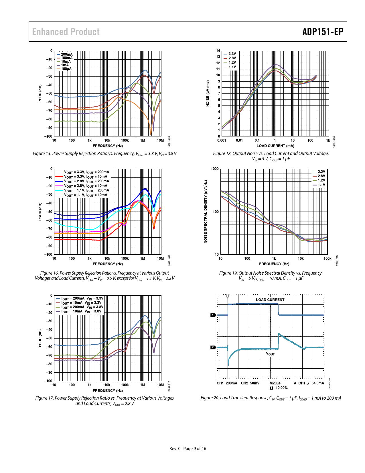

Enhanced Product. ADP151-EP. 200mA. 3.3V. –10. 100mA. 2.8V. 10mA. 1.2V. 1mA. –20. 1.1V. 100µA. –30. –40. rms). –50. RR (. –60. –70. –80. –90. –100. 100. 10k. 100k. 10M

10681- Figure 15. Power Supply Rejection Ratio vs. Frequency, VOUT = 3.3 V, VIN = 3.8 V Figure 18. Output Noise vs. Load Current and Output Voltage, VIN = 5 V, COUT = 1 μF

10681- Figure 16. Power Supply Rejection Ratio vs. Frequency at Various Output Figure 19. Output Noise Spectral Density vs. Frequency, Voltages and Load Currents, VOUT − VIN = 0.5 V, except for VOUT = 1.1 V, VIN = 2.2 V VIN = 5 V, ILOAD = 10 mA, COUT = 1 μF

CH1 200mA CH2 50mV M20µs A CH1 64.0mA 10 100 1k 10k 100k 1M 10M

FREQUENCY (Hz)
10681- Figure 17. Power Supply Rejection Ratio vs. Frequency at Various Voltages Figure 20. Load Transient Response, CIN, COUT = 1 μF, ILOAD = 1 mA to 200 mA and Load Currents, VOUT = 2.8 V Rev. 0 | Page 9 of 16 Document Outline Features Applications Typical Application Circuit General Description Revision History Specifications Input and Output Capacitor, Recommended Specifications Absolute Maximum Ratings Thermal Data Thermal Resistance ESD Caution Pin Configurations and Function Descriptions Typical Performance Characteristics Applications Information Thermal Considerations Printed Circuit Board Layout Considerations Outline Dimensions Ordering Guide
