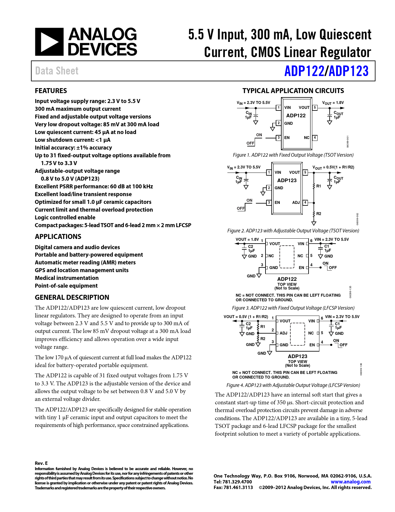

5.5 V Input, 300 mA, Low Quiescent. Current, CMOS Linear Regulator. Data Sheet. ADP122/. ADP123. FEATURES
Datasheet ADP122, ADP123 Analog Devices, Revision: E
5.5 V Input, 300 mA, Low Quiescent Current, CMOS Linear Regulator Data Sheet ADP122/ ADP123 FEATURES TYPICAL APPLICATION CIRCUITS Input voltage supply range: 2.3 V to 5.5 V VIN = 2.3V TO 5.5V VOUT = 1.8V 300 mA maximum output current 1 VIN VOUT 5 C C Fixed and adjustable output voltage versions IN OUT 1µF ADP122 1µF Very low dropout voltage: 85 mV at 300 mA load 2 GND Low quiescent current: 45 µA at no load ON Low shutdown current: <1 µA 3 EN NC 4
001
OFF Initial accuracy: ±1% accuracy
08399-
Up to 31 fixed-output voltage options available from
Figure 1. ADP122 with Fixed Output Voltage (TSOT Version)
1.75 V to 3.3 V V Adjustable-output voltage range IN = 2.3V TO 5.5V VOUT = 0.5V(1 + R1/R2) 1 VIN VOUT 5 0.8 V to 5.0 V (ADP123) CIN COUT 1µF ADP123 1µF Excellent PSRR performance: 60 dB at 100 kHz R1 2 GND Excellent load/line transient response Optimized for small 1.0 μF ceramic capacitors ON 3 EN ADJ 4 Current limit and thermal overload protection OFF R2 Logic controlled enable
002
Compact packages: 5-lead TSOT and 6-lead 2 mm × 2 mm LFCSP
08399- Figure 2. ADP123 with Adjustable Output Voltage (TSOT Version)
APPLICATIONS VOUT = 1.8V 1 6 VIN = 2.3V TO 5.5V Digital camera and audio devices VOUT VIN C2 C1 1µF 1µF Portable and battery-powered equipment GND 2 NC NC 5 GND Automatic meter reading (AMR) meters 3 4 ON GPS and location management units GND EN OFF Medical instrumentation GND ADP122 Point-of-sale equipment TOP VIEW (Not to Scale)
135
GENERAL DESCRIPTION NC = NOT CONNECT. THIS PIN CAN BE LEFT FLOATING
08399-
OR CONNECTED TO GROUND.
The ADP122/ADP123 are low quiescent current, low dropout Figure 3. ADP122 with Fixed Output Voltage (LFCSP Version) linear regulators. They are designed to operate from an input
VOUT = 0.5V (1 + R1/R2) 1 6 VIN = 2.3V TO 5.5V
voltage between 2.3 V and 5.5 V and to provide up to 300 mA of
VOUT VIN C2 C1
output current. The low 85 mV dropout voltage at a 300 mA load
1µF R1 1µF 2 GND ADJ NC 5 GND
improves efficiency and al ows operation over a wide input
R2 3 4 ON
voltage range.
GND GND EN OFF
The low 170 μA of quiescent current at ful load makes the ADP122
GND ADP123
ideal for battery-operated portable equipment.
136 The ADP122 is capable of 31 fixed output voltages from 1.75 V
08399-
to 3.3 V. The ADP123 is the adjustable version of the device and Figure 4. ADP123 with Adjustable Output Voltage (LFCSP Version) al ows the output voltage to be set between 0.8 V and 5.0 V by The ADP122/ADP123 have an internal soft start that gives a an external voltage divider. constant start-up time of 350 µs. Short-circuit protection and The ADP122/ADP123 are specifical y designed for stable operation thermal overload protection circuits prevent damage in adverse with tiny 1 µF ceramic input and output capacitors to meet the conditions. The ADP122/ADP123 are available in a tiny, 5-lead requirements of high performance, space constrained applications. TSOT package and 6-lead LFCSP package for the smallest footprint solution to meet a variety of portable applications.
