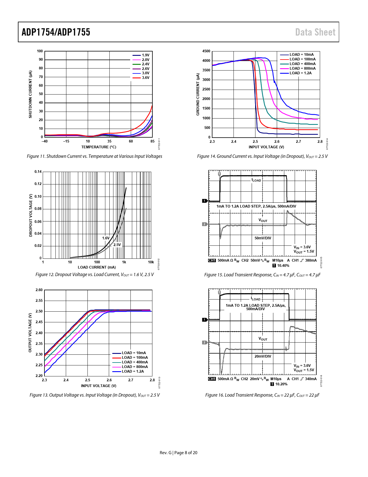

Datasheet ADP1754, ADP1755 (Analog Devices) - 8
Description1.2A Low-Vin, Adjustable-Vout LDO Linear Regulator
Pages / Page20 / 8 — ADP1754/ADP1755. Data Sheet. 100. 4500. 1.9V. LOAD = 10mA. 2.0V. 4000. …
RevisionG
ADP1754/ADP1755. Data Sheet. 100. 4500. 1.9V. LOAD = 10mA. 2.0V. 4000. LOAD = 100mA. 2.4V. LOAD = 400mA. 2.6V. 3500. LOAD = 800mA. LOAD = 1.2A. 3.0V
ADP1754/ADP1755 Data Sheet 100 4500 1.9V LOAD = 10mA 2.0V 4000 LOAD = 100mA 2.4V LOAD = 400mA 2.6V 3500 LOAD = 800mA LOAD = 1.2A 3.0V
ADP1754/ADP1755 Data Sheet 100 4500 1.9V LOAD = 10mA 90 2.0V 4000 LOAD = 100mA 2.4V LOAD = 400mA 80 2.6V 3500 LOAD = 800mA A) LOAD = 1.2A µ 3.0V ( 70 3.6V A) µ ( 3000 NT 60 NT 2500 50 N CURRE 2000 W 40 D CURRE O D UN 1500 30 RO HUT G S 20 1000 10 500 0 0 –40 –15 10 35 60 85
11 14 0
2.3 2.4 2.5 2.6 2.7 2.8
0 2- 2-
TEMPERATURE (°C)
72
INPUT VOLTAGE (V)
72 07 07 Figure 11. Shutdown Current vs. Temperature at Various Input Voltages Figure 14. Ground Current vs. Input Voltage (in Dropout), VOUT = 2.5 V
0.14 T ILOAD 0.12 ) V 0.10 ( E 1 AG 1mA TO 1.2A LOAD STEP, 2.5A/µs, 500mA/DIV T 0.08 L O V V UT 0.06 OUT O 2 P 0.04 DRO 1.6V 50mV/DIV 0.02 2.5V VIN = 3.6V VOUT = 1.5V 0
5 01
1 10 100 1k 10k
12
CH1 500mA Ω B
0
W CH2 50mV BW M10µs A CH1 380mA
2- 2- 72
LOAD CURRENT (mA) T 10.40%
772 07 0 Figure 12. Dropout Voltage vs. Load Current, VOUT = 1.6 V, 2.5 V Figure 15. Load Transient Response, CIN = 4.7 μF, COUT = 4.7 μF
2.60 T I 2.55 LOAD 1mA TO 1.2A LOAD STEP, 2.5A/µs, 500mA/DIV 2.50 ) V ( E 1 2.45 G A LT O 2.40 V T V U OUT 2.35 2 TP OU 2.30 LOAD = 10mA LOAD = 100mA 20mV/DIV LOAD = 400mA 2.25 LOAD = 800mA VIN = 3.6V LOAD = 1.2A VOUT = 1.5V 2.20
6
13
CH1 500mA Ω B
01 0
W CH2 20mV BW M10µs A CH1 340mA
2- 2- 72
INPUT VOLTAGE (V)
72
T 10.20%
07 07 Figure 13. Output Voltage vs. Input Voltage (in Dropout), VOUT = 2.5 V Figure 16. Load Transient Response, CIN = 22 μF, COUT = 22 μF Rev. G | Page 8 of 20 Document Outline Features Applications Typical Application Circuits General Description Table of Contents Revision History Specifications Input and Output Capacitor, Recommended Specifications Absolute Maximum Ratings Thermal Data Thermal Resistance ESD Caution Pin Configurations and Function Descriptions Typical Performance Characteristics Theory of Operation Soft Start Function (ADP1754/ADP1755) Adjustable Output Voltage (ADP1755) Enable Feature Power-Good Feature Reverse Current Protection Feature Applications Information Capacitor Selection Output Capacitor Input Bypass Capacitor Input and Output Capacitor Properties Undervoltage Lockout Current-Limit and Thermal Overload Protection Thermal Considerations PCB Layout Considerations Outline Dimensions Ordering Guide
