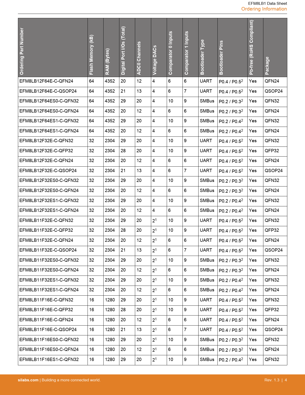

Pages / Page77 / 4 — Ordering Part Number. Flash Memory (kB). RAM (Bytes). Digital Port I/Os …
Ordering Part Number. Flash Memory (kB). RAM (Bytes). Digital Port I/Os (Total). ADC0 Channels. Voltage DACs. Comparator 0 Inputs
Ordering Part Number Flash Memory (kB) RAM (Bytes) Digital Port I/Os (Total) ADC0 Channels Voltage DACs Comparator 0 Inputs
link to page 5 link to page 5 link to page 5 link to page 5 link to page 5 link to page 5 link to page 5 link to page 5 link to page 5 link to page 5 link to page 5 link to page 5 link to page 5 link to page 5 link to page 5 link to page 5 link to page 5 link to page 5 link to page 5 link to page 5 link to page 5 link to page 5 link to page 5 link to page 5 link to page 5 link to page 5 link to page 5 link to page 5 link to page 5 link to page 5 link to page 5 link to page 5 link to page 5 link to page 5 link to page 5 link to page 5 link to page 5 link to page 5 link to page 5 link to page 5 link to page 5 link to page 5 link to page 5 link to page 5 EFM8LB1 Data Sheet Ordering Information
Ordering Part Number Flash Memory (kB) RAM (Bytes) Digital Port I/Os (Total) ADC0 Channels Voltage DACs Comparator 0 Inputs Comparator 1 Inputs Bootloader Type Bootloader Pins Pb-free (RoHS Compliant) Package
EFM8LB12F64E-C-QFN24 64 4352 20 12 4 6 6 UART P0.4 / P0.52 Yes QFN24 EFM8LB12F64E-C-QSOP24 64 4352 21 13 4 6 7 UART P0.4 / P0.52 Yes QSOP24 EFM8LB12F64ES0-C-QFN32 64 4352 29 20 4 10 9 SMBus P0.2 / P0.32 Yes QFN32 EFM8LB12F64ES0-C-QFN24 64 4352 20 12 4 6 6 SMBus P0.2 / P0.32 Yes QFN24 EFM8LB12F64ES1-C-QFN32 64 4352 29 20 4 10 9 SMBus P0.2 / P0.42 Yes QFN32 EFM8LB12F64ES1-C-QFN24 64 4352 20 12 4 6 6 SMBus P0.2 / P0.42 Yes QFN24 EFM8LB12F32E-C-QFN32 32 2304 29 20 4 10 9 UART P0.4 / P0.52 Yes QFN32 EFM8LB12F32E-C-QFP32 32 2304 28 20 4 10 9 UART P0.4 / P0.52 Yes QFP32 EFM8LB12F32E-C-QFN24 32 2304 20 12 4 6 6 UART P0.4 / P0.52 Yes QFN24 EFM8LB12F32E-C-QSOP24 32 2304 21 13 4 6 7 UART P0.4 / P0.52 Yes QSOP24 EFM8LB12F32ES0-C-QFN32 32 2304 29 20 4 10 9 SMBus P0.2 / P0.32 Yes QFN32 EFM8LB12F32ES0-C-QFN24 32 2304 20 12 4 6 6 SMBus P0.2 / P0.32 Yes QFN24 EFM8LB12F32ES1-C-QFN32 32 2304 29 20 4 10 9 SMBus P0.2 / P0.42 Yes QFN32 EFM8LB12F32ES1-C-QFN24 32 2304 20 12 4 6 6 SMBus P0.2 / P0.42 Yes QFN24 EFM8LB11F32E-C-QFN32 32 2304 29 20 21 10 9 UART P0.4 / P0.52 Yes QFN32 EFM8LB11F32E-C-QFP32 32 2304 28 20 21 10 9 UART P0.4 / P0.52 Yes QFP32 EFM8LB11F32E-C-QFN24 32 2304 20 12 21 6 6 UART P0.4 / P0.52 Yes QFN24 EFM8LB11F32E-C-QSOP24 32 2304 21 13 21 6 7 UART P0.4 / P0.52 Yes QSOP24 EFM8LB11F32ES0-C-QFN32 32 2304 29 20 21 10 9 SMBus P0.2 / P0.32 Yes QFN32 EFM8LB11F32ES0-C-QFN24 32 2304 20 12 21 6 6 SMBus P0.2 / P0.32 Yes QFN24 EFM8LB11F32ES1-C-QFN32 32 2304 29 20 21 10 9 SMBus P0.2 / P0.42 Yes QFN32 EFM8LB11F32ES1-C-QFN24 32 2304 20 12 21 6 6 SMBus P0.2 / P0.42 Yes QFN24 EFM8LB11F16E-C-QFN32 16 1280 29 20 21 10 9 UART P0.4 / P0.52 Yes QFN32 EFM8LB11F16E-C-QFP32 16 1280 28 20 21 10 9 UART P0.4 / P0.52 Yes QFP32 EFM8LB11F16E-C-QFN24 16 1280 20 12 21 6 6 UART P0.4 / P0.52 Yes QFN24 EFM8LB11F16E-C-QSOP24 16 1280 21 13 21 6 7 UART P0.4 / P0.52 Yes QSOP24 EFM8LB11F16ES0-C-QFN32 16 1280 29 20 21 10 9 SMBus P0.2 / P0.32 Yes QFN32 EFM8LB11F16ES0-C-QFN24 16 1280 20 12 21 6 6 SMBus P0.2 / P0.32 Yes QFN24 EFM8LB11F16ES1-C-QFN32 16 1280 29 20 21 10 9 SMBus P0.2 / P0.42 Yes QFN32
