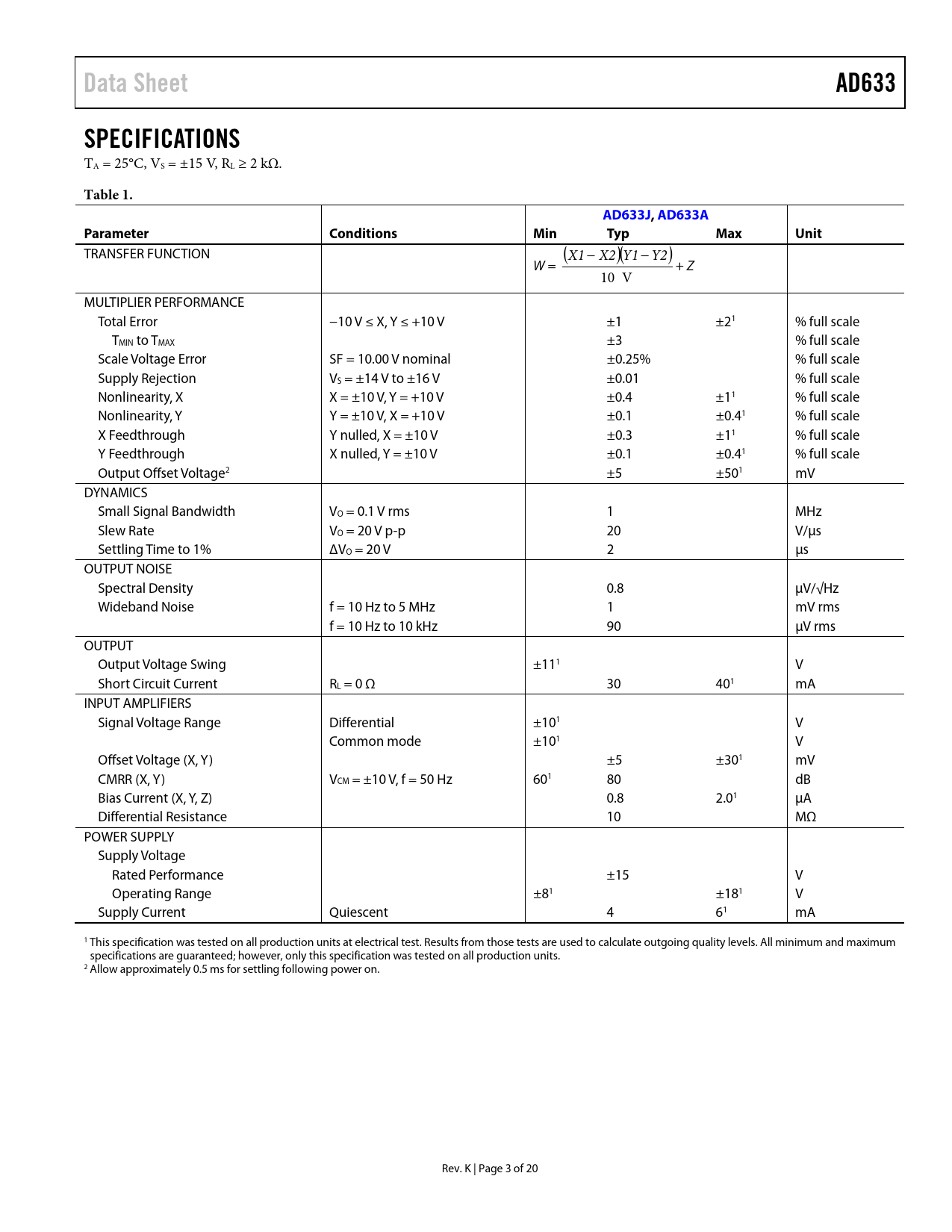

Data Sheet. AD633. SPECIFICATIONS. Table 1. AD633J, AD633A. Parameter. Conditions. Min. Typ. Max. Unit
Data Sheet AD633 SPECIFICATIONS Table 1 AD633J, AD633A Parameter Conditions Min Typ Max Unit
TA = 25°C, VS = ±15 V, RL ≥ 2 kΩ.
Table 1. AD633J, AD633A Parameter Conditions Min Typ Max Unit
TRANSFER FUNCTION (X1− X2)(Y1−Y2) W = + Z 10 V MULTIPLIER PERFORMANCE Total Error −10 V ≤ X, Y ≤ +10 V ±1 ±21 % full scale TMIN to TMAX ±3 % full scale Scale Voltage Error SF = 10.00 V nominal ±0.25% % full scale Supply Rejection VS = ±14 V to ±16 V ±0.01 % full scale Nonlinearity, X X = ±10 V, Y = +10 V ±0.4 ±11 % full scale Nonlinearity, Y Y = ±10 V, X = +10 V ±0.1 ±0.41 % full scale X Feedthrough Y nulled, X = ±10 V ±0.3 ±11 % full scale Y Feedthrough X nulled, Y = ±10 V ±0.1 ±0.41 % full scale Output Offset Voltage2 ±5 ±501 mV DYNAMICS Small Signal Bandwidth VO = 0.1 V rms 1 MHz Slew Rate VO = 20 V p-p 20 V/µs Settling Time to 1% ΔVO = 20 V 2 µs OUTPUT NOISE Spectral Density 0.8 µV/√Hz Wideband Noise f = 10 Hz to 5 MHz 1 mV rms f = 10 Hz to 10 kHz 90 µV rms OUTPUT Output Voltage Swing ±111 V Short Circuit Current RL = 0 Ω 30 401 mA INPUT AMPLIFIERS Signal Voltage Range Differential ±101 V Common mode ±101 V Offset Voltage (X, Y) ±5 ±301 mV CMRR (X, Y) VCM = ±10 V, f = 50 Hz 601 80 dB Bias Current (X, Y, Z) 0.8 2.01 µA Differential Resistance 10 MΩ POWER SUPPLY Supply Voltage Rated Performance ±15 V Operating Range ±81 ±181 V Supply Current Quiescent 4 61 mA 1 This specification was tested on all production units at electrical test. Results from those tests are used to calculate outgoing quality levels. All minimum and maximum specifications are guaranteed; however, only this specification was tested on al production units. 2 Allow approximately 0.5 ms for settling following power on. Rev. K | Page 3 of 20 Document Outline FEATURES APPLICATIONS FUNCTIONAL BLOCK DIAGRAM GENERAL DESCRIPTION PRODUCT HIGHLIGHTS TABLE OF CONTENTS REVISION HISTORY SPECIFICATIONS ABSOLUTE MAXIMUM RATINGS THERMAL RESISTANCE ESD CAUTION PIN CONFIGURATIONS AND FUNCTION DESCRIPTIONS TYPICAL PERFORMANCE CHARACTERISTICS FUNCTIONAL DESCRIPTION ERROR SOURCES APPLICATIONS INFORMATION MULTIPLIER CONNECTIONS SQUARING AND FREQUENCY DOUBLING GENERATING INVERSE FUNCTIONS VARIABLE SCALE FACTOR CURRENT OUTPUT LINEAR AMPLITUDE MODULATOR VOLTAGE-CONTROLLED, LOW-PASS AND HIGH-PASS FILTERS VOLTAGE-CONTROLLED QUADRATURE OSCILLATOR AUTOMATIC GAIN CONTROL (AGC) AMPLIFIERS MODEL RESULTS EXAMPLES OF DC, SIN, AND PULSE SOLUTIONS USING MULTISIM EXAMPLES OF DC, SIN, AND PULSE SOLUTIONS USING PSPICE EXAMPLES OF DC, SIN, AND PULSE SOLUTIONS USING SIMETRIX EVALUATION BOARD OUTLINE DIMENSIONS ORDERING GUIDE
