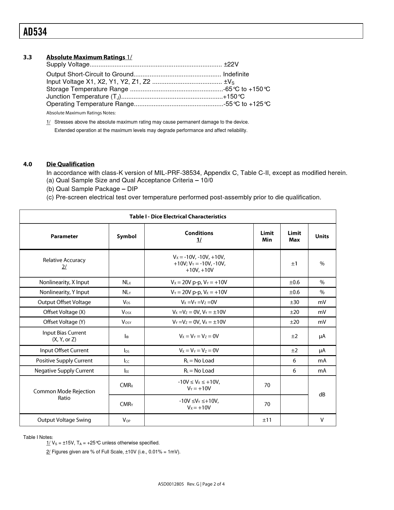

DescriptionInternally Trimmed Precision IC Multiplier
Pages / Page4 / 2 — . Supply. Voltage.. ±22V. Output. Short-Circuit. to. Ground... …
File Format / SizePDF / 437 Kb
. Supply. Voltage.. ±22V. Output. Short-Circuit. to. Ground... Indefinite. Input. Voltage. X1,. X2,. Y1,. Y2,. Z1,. Z2. ... ±VS. Storage. Temperature. Range
 Supply Voltage. ±22V Output Short-Circuit to Ground.. Indefinite Input Voltage X1, X2, Y1, Y2, Z1, Z2 .. ±VS Storage Temperature Range
Supply Voltage.. ±22V Output Short-Circuit to Ground... Indefinite Input Voltage X1, X2, Y1, Y2, Z1, Z2 ... ±VS Storage Temperature Range ..-65°C to +150°C Junction Temperature (TJ)...+150°C Operating Temperature Range..-55°C to +125°C 1/ Stresses above the absolute maximum rating may cause permanent damage to the device. Extended operation at the maximum levels may degrade performance and affect reliability. In accordance with class-K version of MIL-PRF-38534, Appendix C, Table C-II, except as modified herein. (a) Qual Sample Size and Qual Acceptance Criteria – 10/0 (b) Qual Sample Package – DIP (c) Pre-screen electrical test over temperature performed post-assembly prior to die qualification. Table I Notes 1/ VS = ±15V, TA = +25°C unless otherwise specified. 2/ Figures given are % of Full Scale, ±10V (i.e., 0.01% = 1mV).
