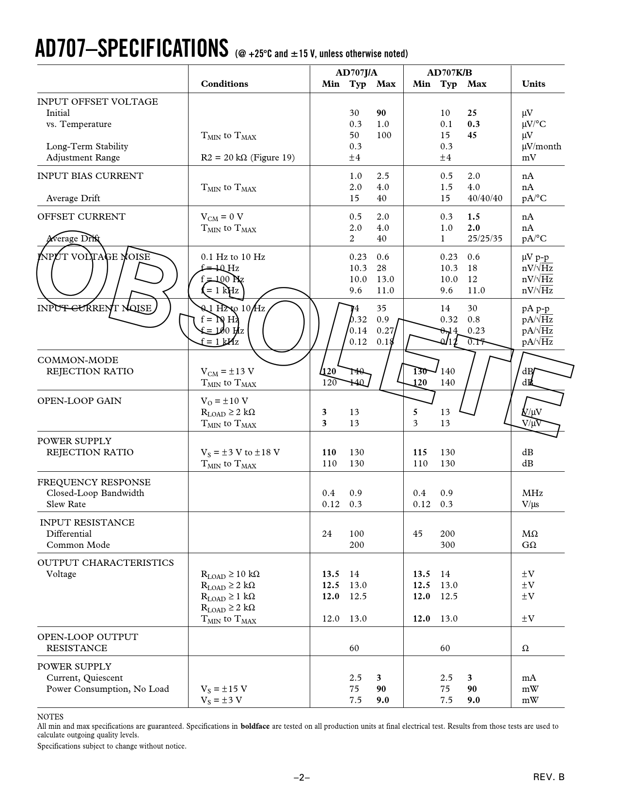

AD707–SPECIFICATIONS (@ +25. C and. 15 V, unless otherwise noted). AD707J/A. AD707K/B. Conditions. Min. Typ. Max. Units. 0.3. 1.5. 2.0. OBSOLETE
AD707–SPECIFICATIONS (@ +25 C and 15 V, unless otherwise noted) AD707J/A AD707K/B Conditions Min Typ Max Units 0.3 1.5 2.0 OBSOLETE
8
C and
6
15 V, unless otherwise noted) AD707J/A AD707K/B Conditions Min Typ Max Min Typ Max Units
INPUT OFFSET VOLTAGE Initial 30
90
10
25
µV vs. Temperature 0.3 1.0 0.1
0.3
µV/°C TMIN to TMAX 50 100 15
45
µV Long-Term Stability 0.3 0.3 µV/month Adjustment Range R2 = 20 kΩ (Figure 19) ±4 ±4 mV INPUT BIAS CURRENT 1.0 2.5 0.5 2.0 nA TMIN to TMAX 2.0 4.0 1.5 4.0 nA Average Drift 15 40 15 40/40/40 pA/°C OFFSET CURRENT VCM = 0 V 0.5 2.0 0.3
1.5
nA TMIN to TMAX 2.0 4.0 1.0
2.0
nA Average Drift 2 40 1 25/25/35 pA/°C INPUT VOLTAGE NOISE 0.1 Hz to 10 Hz 0.23 0.6 0.23 0.6 µV p-p f = 10 Hz 10.3 28 10.3 18 nV/√Hz
OBSOLETE
f = 100 Hz 10.0 13.0 10.0 12 nV/√Hz f = 1 kHz 9.6 11.0 9.6 11.0 nV/√Hz INPUT CURRENT NOISE 0.1 Hz to 10 Hz 14 35 14 30 pA p-p f = 10 Hz 0.32 0.9 0.32 0.8 pA/√Hz f = 100 Hz 0.14 0.27 0.14 0.23 pA/√Hz f = 1 kHz 0.12 0.18 0.12 0.17 pA/√Hz COMMON-MODE REJECTION RATIO VCM = ± 13 V
120
140
130
140 dB TMIN to TMAX 120 140
120
140 dB OPEN-LOOP GAIN VO = ± 10 V RLOAD ≥ 2 kΩ
3
13
5
13 V/µV TMIN to TMAX
3
13 3 13 V/µV POWER SUPPLY REJECTION RATIO VS = ± 3 V to ± 18 V
110
130
115
130 dB TMIN to TMAX 110 130 110 130 dB FREQUENCY RESPONSE Closed-Loop Bandwidth 0.4 0.9 0.4 0.9 MHz Slew Rate 0.12 0.3 0.12 0.3 V/µs INPUT RESISTANCE Differential 24 100 45 200 MΩ Common Mode 200 300 GΩ OUTPUT CHARACTERISTICS Voltage RLOAD ≥ 10 kΩ
13.5
14
13.5
14 ±V RLOAD ≥ 2 kΩ
12.5
13.0
12.5
13.0 ±V RLOAD ≥ 1 kΩ
12.0
12.5
12.0
12.5 ±V RLOAD ≥ 2 kΩ TMIN to TMAX 12.0 13.0
12.0
13.0 ±V OPEN-LOOP OUTPUT RESISTANCE 60 60 Ω POWER SUPPLY Current, Quiescent 2.5
3
2.5
3
mA Power Consumption, No Load VS = ± 15 V 75
90
75
90
mW VS = ± 3 V 7.5
9.0
7.5
9.0
mW NOTES All min and max specifications are guaranteed. Specifications in
boldface
are tested on all production units at final electrical test. Results from those tests are used to calculate outgoing quality levels. Specifications subject to change without notice. –2– REV. B
