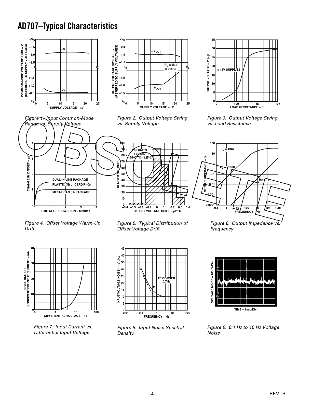

AD707–Typical Characteristics. –0.5. + V. OUT. –1.0. –1.5. RL = 2k. @ +25. 15V SUPPLIES. +1.5. +1.0. – VOUT. OUTPUT VOLTAGE – V p -p. +0.5
AD707–Typical Characteristics –0.5 + V OUT –1.0 –1.5 RL = 2k @ +25 15V SUPPLIES +1.5 +1.0 – VOUT OUTPUT VOLTAGE – V p -p +0.5
AD707–Typical Characteristics +V +V S S 35 –0.5 –0.5 30 +V + V
V OUT –1.0 –1.0 25 –1.5 –1.5 RL = 2k
20 @ +25
C
15V SUPPLIES 15 +1.5 +1.5 10 +1.0 +1.0 – VOUT –V OUTPUT VOLTAGE – V p -p +0.5 OUTPUT VOLTAGE SWING – +0.5 5 COMMOM-MODE VOLTAGE LIMIT – V (REFERRED TO SUPPLY VOLTAGES) (REFERRED TO SUPPLY VOLTAGES) –V –V S S 0 0 5 10 15 20 25 0 5 10 15 20 25 10 100 1k 10k SUPPLY VOLTAGE –
V SUPPLY VOLTAGE –
V LOAD RESISTANCE –
Ω Figure 1. Input Common-Mode Figure 2. Output Voltage Swing Figure 3. Output Voltage Swing Range vs. Supply Voltage vs. Supply Voltage vs. Load Resistance
OBSOLETE 4 100 100 90 256 UNITS IO = 1mA TESTED 10 80 – 55
C TO +125
C
3 70 1 60 AV = +1000 2 50 0.1 DUAL-IN-LINE PACKAGE 40 AV = +1 PLASTIC (N) or CERDIP (Q) 0.01 NUMBER OF UNITS 30 CHANGE IN OFFSET – µV 1 METAL CAN (H) PACKAGE 20 OUTPUT IMPEDANCE – 0.001 10 0 0 0.0001 0 1 2 3 4 –0.4 –0.3 –0.2 –0.1 0 0.1 0.2 0.3 0.4 0.1 1 10 100 1k 10k 100k TIME AFTER POWER ON – Minutes OFFSET VOLTAGE DRIFT – µV/
C FREQUENCY – Hz
Figure 4. Offset Voltage Warm-Up Figure 5. Typical Distribution of Figure 6. Output Impedance vs. Drift Offset Voltage Drift Frequency
40 45 40
Hz 35 30 100 30 90 25 I/F CORNER 20 0.7Hz 20 INVERTING OR 15 10 10 10 0% INPUT VOLTAGE NOISE – nV/ VOLTAGE NOISE – 100nV/Div 5 NONINVERTING INPUT CURRENT – mA 0 0 TIME – 1sec/Div 0 1 10 100 0.01 0.1 1 10 100 DIFFERENTIAL VOLTAGE –
V FREQUENCY – Hz
Figure 7. Input Current vs. Figure 8. Input Noise Spectral Figure 9. 0.1 Hz to 10 Hz Voltage Differential Input Voltage Density Noise –4– REV. B
