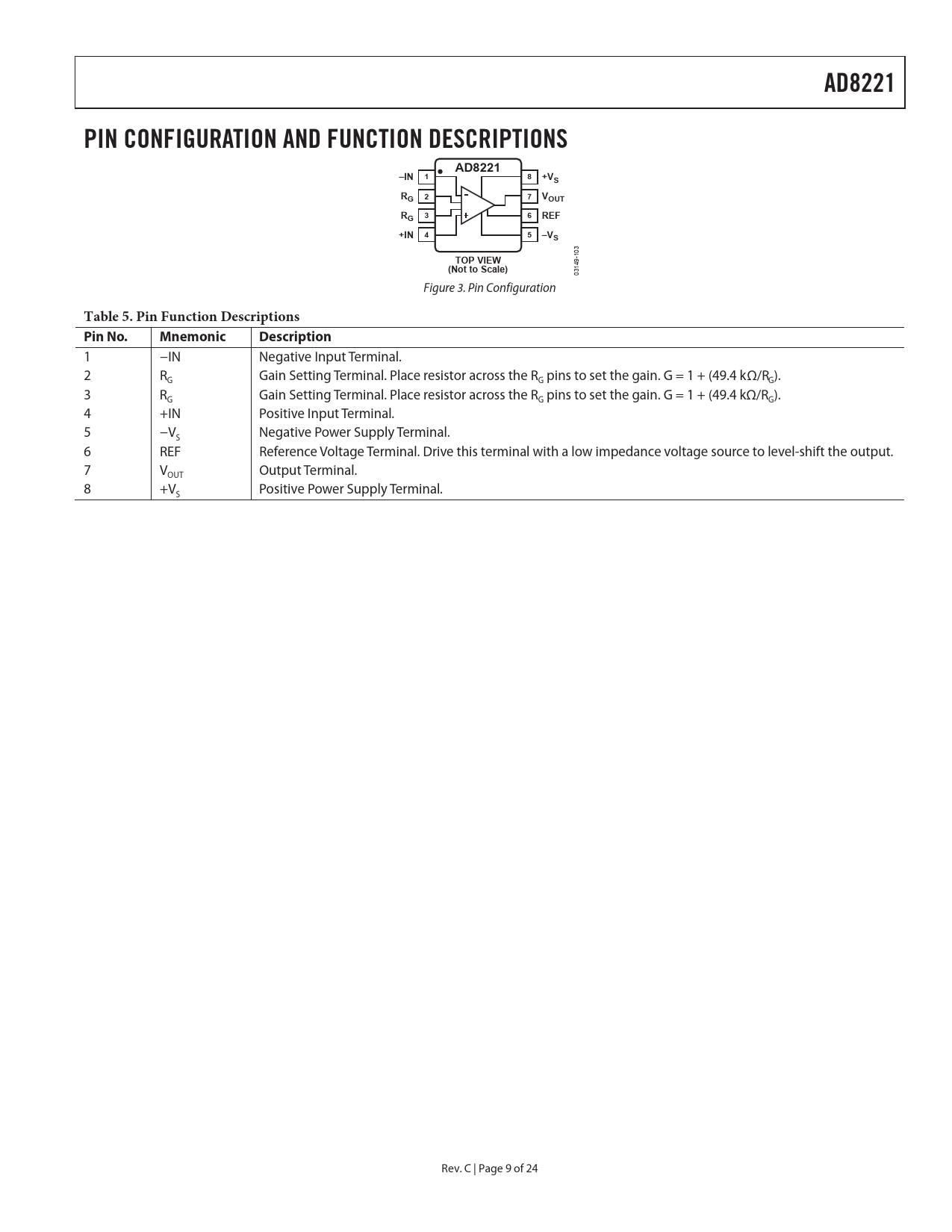

AD8221 PIN CONFIGURATION AND FUNCTION DESCRIPTIONS
AD8221 –IN 1 8 +VS RG 2 7 VOUT RG 3 6 REF +IN 4 5 –VS

1 3 0 Figure 3. Pin Configuration
Table 5. Pin Function Descriptions Pin No. Mnemonic Description
1 −IN Negative Input Terminal. 2 R Gain Setting Terminal. Place resistor across the R pins to set the gain. G = 1 + (49.4 kΩ/R ). G G G 3 R Gain Setting Terminal. Place resistor across the R pins to set the gain. G = 1 + (49.4 kΩ/R ). G G G 4 +IN Positive Input Terminal. 5 −V Negative Power Supply Terminal. S 6 REF Reference Voltage Terminal. Drive this terminal with a low impedance voltage source to level-shift the output. 7 V Output Terminal. OUT 8 +V Positive Power Supply Terminal. S Rev. C | Page 9 of 24
