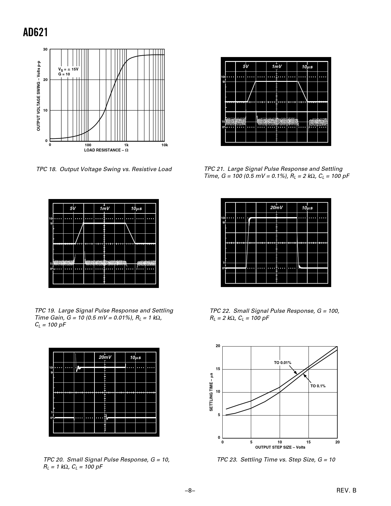

AD621. 1mV. VS =. 15V G = 10. Volts p-p. 100. – 20. OUTPUT VOLTAGE SWING. 10k. LOAD RESISTANCE –. 20mV. TO 0.01%. TO 0.1%. SETTLING TIME
AD621 30 5V 1mV 10
s VS =
ⴞ
15V G = 10 Volts p-p 100 – 20 90 10 10 0% OUTPUT VOLTAGE SWING 0 0 100 1k 10k LOAD RESISTANCE –
⍀ TPC 18. Output Voltage Swing vs. Resistive Load TPC 21. Large Signal Pulse Response and Settling Time, G = 100 (0.5 mV = 0.1%), RL = 2 kΩ, CL = 100 pF
5V 1mV 10
s 20mV 10
s 100 100 90 90 10 10 0% 0%
TPC 19. Large Signal Pulse Response and Settling TPC 22. Small Signal Pulse Response, G = 100, Time Gain, G = 10 (0.5 mV = 0.01%), RL = 1 kΩ, RL = 2 kΩ, CL = 100 pF CL = 100 pF
20 20mV 10
s TO 0.01% 100 15 90 s
– TO 0.1% 10 SETTLING TIME 10 5 0% 0 0 5 10 15 20 OUTPUT STEP SIZE – Volts
TPC 20. Small Signal Pulse Response, G = 10, TPC 23. Settling Time vs. Step Size, G = 10 RL = 1 kΩ, CL = 100 pF –8– REV. B
