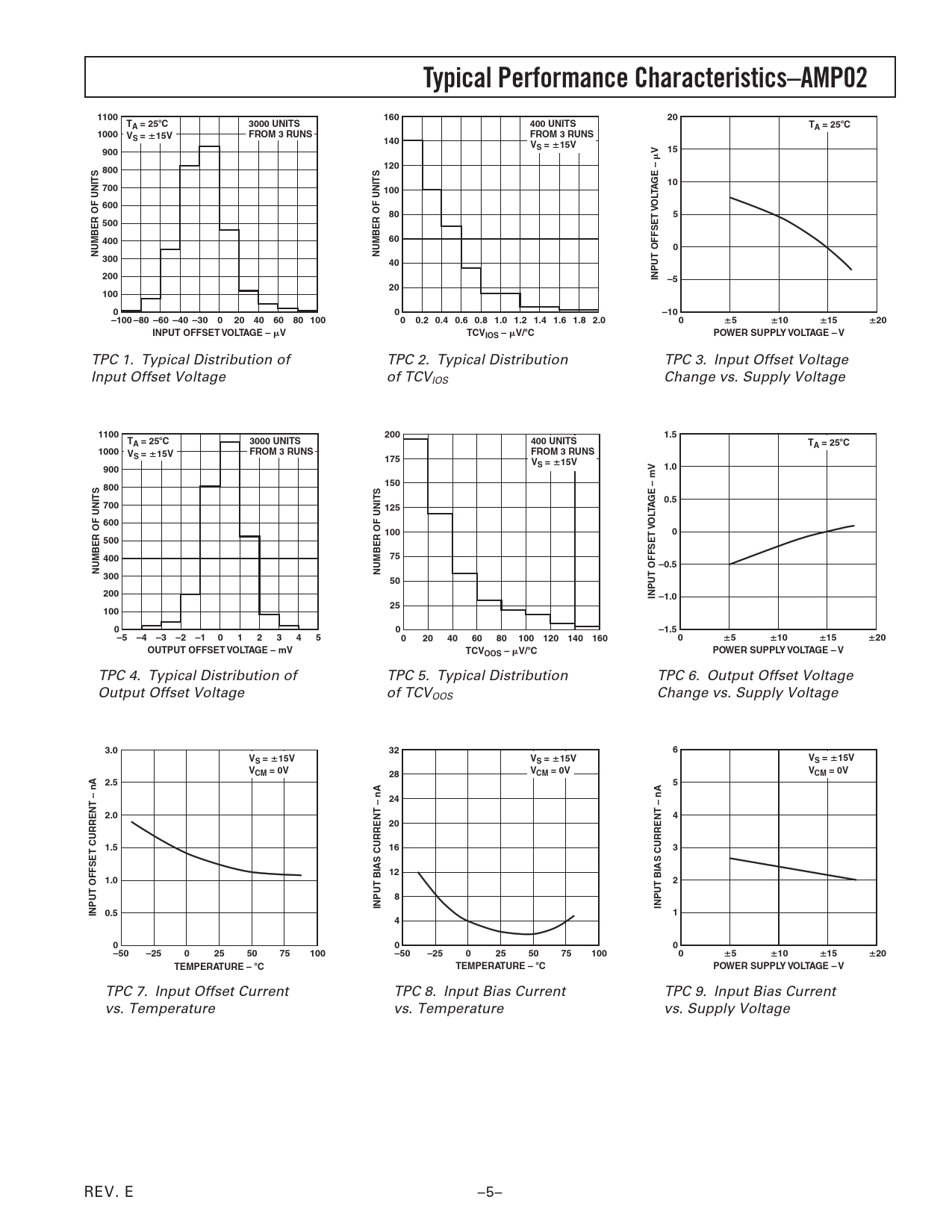

Typical Performance Characteristics–AMP02. 1100. 160. TA = 25. 3000 UNITS. 400 UNITS. 1000 V. FROM 3 RUNS. S =. 15V. 140. VS =. 900. 120. 800. GE –
Typical Performance Characteristics–AMP02 1100 160 TA = 25 3000 UNITS 400 UNITS 1000 V FROM 3 RUNS S = 15V 140 VS = 900 120 800 GE –
Typical Performance Characteristics–AMP02 1100 160 20 TA = 25
C 3000 UNITS 400 UNITS TA = 25
C 1000 V FROM 3 RUNS FROM 3 RUNS S =
15V 140 VS =
15V 900 V 15
120 800 GE – 10 700 100 A T L 600 O V 80 5 500 400 60 0 NUMBER OF UNITS NUMBER OF UNITS 300 40 200 INPUT OFFSET –5 20 100 0 0 –10 –100 –80 –60 –40 –30 0 20 40 60 80 100 0 0.2 0.4 0.6 0.8 1.0 1.2 1.4 1.6 1.8 2.0 0
5
10
15
20 INPUT OFFSET VOLTAGE –
V TCVIOS –
V/
C POWER SUPPLY VOLTAGE – V
TPC 1. Typical Distribution of TPC 2. Typical Distribution TPC 3. Input Offset Voltage Input Offset Voltage of TCVIOS Change vs. Supply Voltage
1100 200 1.5 TA = 25
15V 175 VS =
15V 900 1.0 800 150 GE – mV 0.5 700 125 A T L 600 O V 100 0 500 400 75 –0.5 NUMBER OF UNITS 300 NUMBER OF UNITS 50 200 INPUT OFFSET –1.0 25 100 0 0 –1.5 –5 –4 –3 –2 –1 0 1 2 3 4 5 0 20 40 60 80 100 120 140 160 0
5
10
15
20 OUTPUT OFFSET VOLTAGE – mV TCVOOS –
V/
TPC 4. Typical Distribution of TPC 5. Typical Distribution TPC 6. Output Offset Voltage Output Offset Voltage of TCVOOS Change vs. Supply Voltage
3.0 32 6 VS =
15V VS =
15V VS =
15V VCM = 0V VCM = 0V 28 VCM = 0V 2.5 5 24 2.0 4 20 1.5 16 3 12 1.0 2 8 INPUT BIAS CURRENT – nA INPUT BIAS CURRENT – nA INPUT OFFSET CURRENT – nA 0.5 1 4 0 0 0 –50 –25 0 25 50 75 100 –50 –25 0 25 50 75 100 0
5
10
15
20 TEMPERATURE –
C TEMPERATURE –
TPC 7. Input Offset Current TPC 8. Input Bias Current TPC 9. Input Bias Current vs. Temperature vs. Temperature vs. Supply Voltage REV. E –5– Document Outline FEATURES APPLICATIONS FUNCTIONAL BLOCK DIAGRAM GENERAL DESCRIPTION SPECIFICATIONS ELECTRICAL CHARACTERISTICS ABSOLUTE MAXIMUM RATINGS ORDERING GUIDE WAFER TEST LIMITS Typical Performance Characteristics APPLICATIONS INFORMATION Input and Output Offset Voltages Input Bias and Offset Currents Gain Common-Mode Rejection Grounding Sense and Reference Terminals Overvoltage Protection Power Supply Considerations OUTLINE DIMENSIONS Revision History
