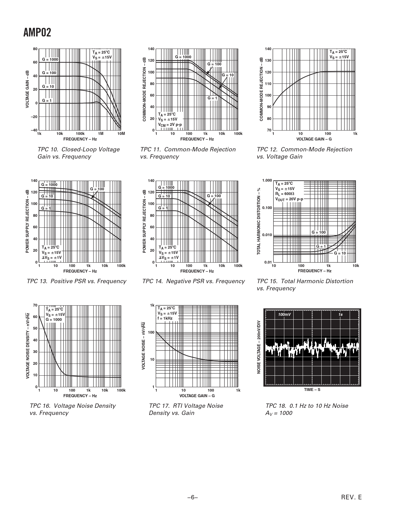

TPC 10. Closed-Loop Voltage TPC 11. Common-Mode Rejection TPC 12. Common-Mode Rejection Gain vs. Frequency vs. Frequency vs. Voltage Gain

TPC 13. Positive PSR vs. Frequency TPC 14. Negative PSR vs. Frequency TPC 15. Total Harmonic Distortion vs. Frequency

TPC 16. Voltage Noise Density TPC 17. RTI Voltage Noise TPC 18. 0.1 Hz to 10 Hz Noise vs. Frequency Density vs. Gain AV = 1000 –6– REV. E Document Outline FEATURES APPLICATIONS FUNCTIONAL BLOCK DIAGRAM GENERAL DESCRIPTION SPECIFICATIONS ELECTRICAL CHARACTERISTICS ABSOLUTE MAXIMUM RATINGS ORDERING GUIDE WAFER TEST LIMITS Typical Performance Characteristics APPLICATIONS INFORMATION Input and Output Offset Voltages Input Bias and Offset Currents Gain Common-Mode Rejection Grounding Sense and Reference Terminals Overvoltage Protection Power Supply Considerations OUTLINE DIMENSIONS Revision History
