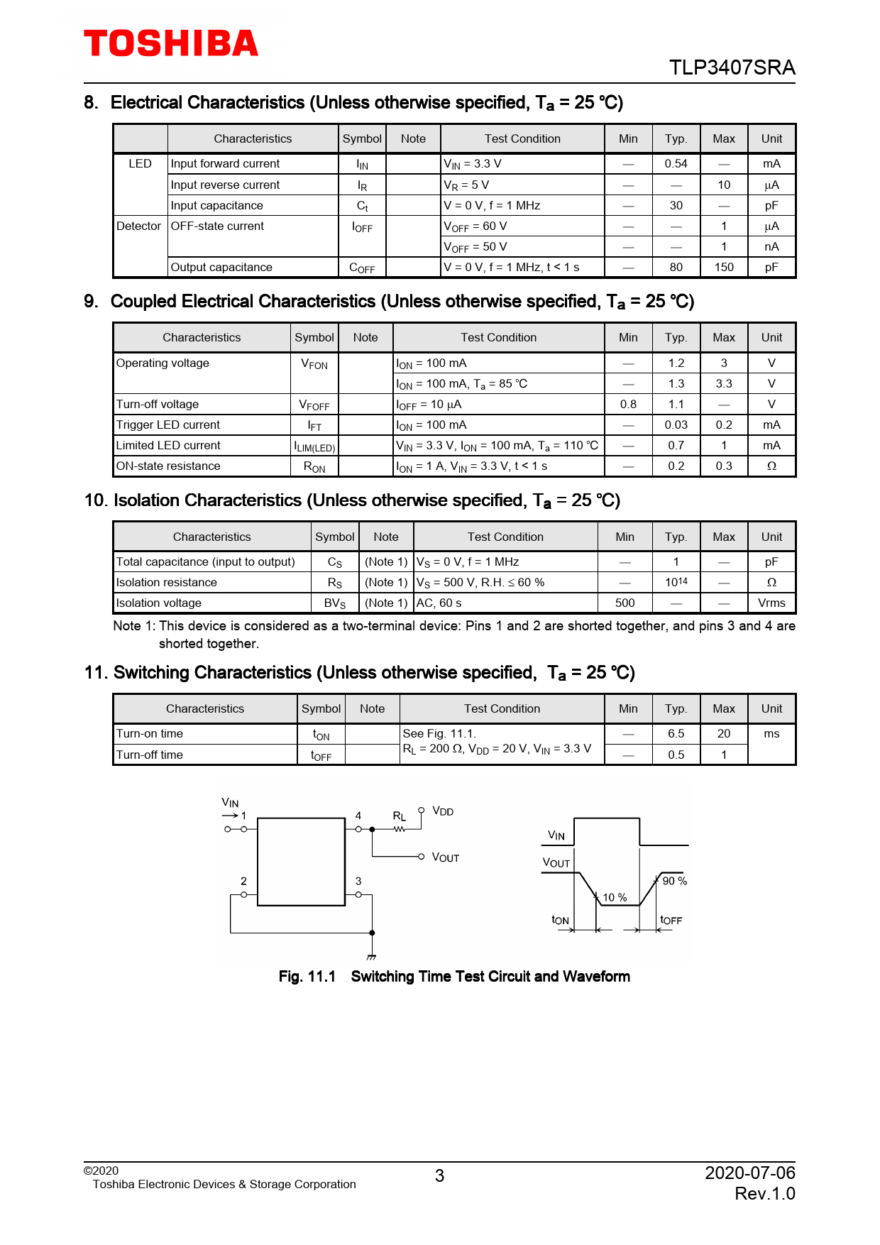

TLP3407SRA. 8. Electrical. Characteristics. (Unless. otherwise. specified,. Ta. =. 25. ). Characteristics. Symbol. Note. Test. Condition. Min. Typ. Max. Unit
TLP3407SRA 8 Electrical Characteristics (Unless otherwise specified, Ta = 25 ) Characteristics Symbol Note Test Condition Min Typ Max Unit
TLP3407SRA 8. Electrical Characteristics (Unless otherwise specified, Ta = 25 ) Characteristics Symbol Note Test Condition Min Typ. Max Unit LED Input forward current IIN VIN = 3.3 V  0.54  mA Input reverse current IR VR = 5 V   10 µA Input capacitance Ct V = 0 V, f = 1 MHz  30  pF Detector OFF-state current IOFF VOFF = 60 V   1 µA VOFF = 50 V   1 nA Output capacitance COFF V = 0 V, f = 1 MHz, t < 1 s  80 150 pF 9. Coupled Electrical Characteristics (Unless otherwise specified, Ta = 25 ) Characteristics Symbol Note Test Condition Min Typ. Max Unit Operating voltage VFON ION = 100 mA  1.2 3 V ION = 100 mA, Ta = 85  1.3 3.3 V Turn-off voltage VFOFF IOFF = 10 µA 0.8 1.1  V Trigger LED current IFT ION = 100 mA  0.03 0.2 mA Limited LED current ILIM(LED) VIN = 3.3 V, ION = 100 mA, Ta = 110  0.7 1 mA ON-state resistance RON ION = 1 A, VIN = 3.3 V, t < 1 s  0.2 0.3 Ω 10. Isolation Characteristics (Unless otherwise specified, Ta = 25 ) Characteristics Symbol Note Test Condition Min Typ. Max Unit Total capacitance (input to output) CS (Note 1) VS = 0 V, f = 1 MHz  1  pF Isolation resistance RS (Note 1) VS = 500 V, R.H. ≤ 60 %  1014  Ω Isolation voltage BVS (Note 1) AC, 60 s 500   Vrms Note 1: This device is considered as a two-terminal device: Pins 1 and 2 are shorted together, and pins 3 and 4 are shorted together. 11. Switching Characteristics (Unless otherwise specified, Ta = 25 ) Characteristics Symbol Note Test Condition Min Typ. Max Unit Turn-on time tON See Fig. 11.1.  6.5 20 ms Turn-off time t RL = 200 Ω, VDD = 20 V, VIN = 3.3 V OFF  0.5 1 Fig. 11.1 Switching Time Test Circuit and Waveform ©2020 3 2020-07-06 Toshiba Electronic Devices & Storage Corporation Rev.1.0
